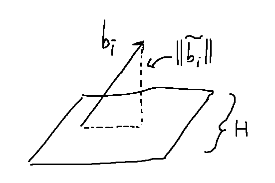

For ##1 \leq i \leq n## concider ##H = span(b_1,...,b_{i-1},b_{i+1},...,b_n)##. Show that ##2^{-n(n-1)/4}||b_i|| \leq dist(H,b_i) \leq || b_i ||##. Hint use ##\prod ||b_i|| \leq 2^{n(n-1)/4} det(\Lambda)##. Own reasoning below.
I would like to show that a LLL-reduced basis satisfies the following property (Reference):
My Idea:
I also have a first approach for the part ##dist(H,b_i) \leq || b_i ||## of the inequality, which I want to present here based on a picture, which is used to explain my thought:
So based on the picture we can see that the norm of the orthogonal part (##\tilde{b_i}##) of the vector ##b_i## gives the distance. Therefor I would argue that ##dist(H,b_i) = ||\tilde{b_i}||## and further ##||\tilde{b_i}|| \leq ||b_i||## since the norm of a Gram-Schmidt vector is less than the norm of the regular vector. If I put this together it makes for me a valid argument to say ##dist(H,b_i) \leq || b_i ||##. This would prove one part of the inequality.

I wanted to ask again if anyone would consider my reasoning to be correct? Or can someone contradict that?
Do you know how ##\det(\Lambda)## is built up by computing ##||\tilde{b_i}||##s?

Hey @Office_Shredder, If I remember correctly, it was this: ##\det(\Lambda) = \prod_{i=1}^n ||\tilde{b_i}||##
That's really the only clever piece. I'll put the rest in spoilers but it's just doing the right algebra, so you should give it a shot yourself.
plugging this into
##\prod ||| b_j|| \leq 2^{n(n-1)/4} \det(\Lambda)##
##\prod ||b_j|| \leq 2^{n(n-1)/4} \prod ||\tilde{b_j}||##
For each ## j\neq i##, ##||\tilde{b_j}|| \leq ||b_j||##. Apply this to the right hand side to get
##\prod ||b_j|| \leq 2^{n(n-1)/4} ||\tilde{b_i}|||\prod_{j\neq i} ||b_j||##
Cancel all the norms left on both sides
Hey @Office_Shredder, then in the end remains: ##2^{-n(n-1)/4}||b_i|| \leq ||\tilde{b_i}||##.
But with my thought above that ##dist(H,b_i) = ||\tilde{b_i}||##, we can derive the required inequality (left side). But this assumes that ##dist(H,b_i) = ||\tilde{b_i}||## is right, and I'am not sure, can you confim that this is right?
You are correct.
