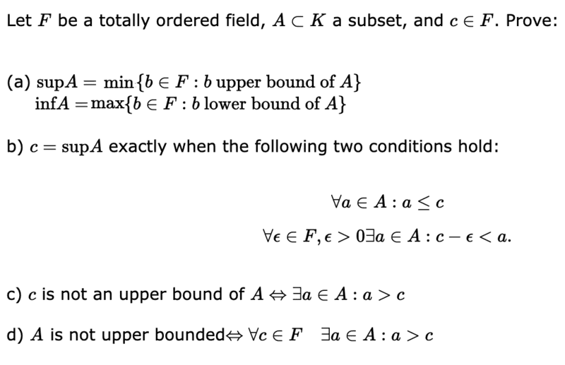

Hi,
I have problems with the proof for task a
I started with the supremum first, but the proof for the infimum would go the same way. I used an epsilon neighborhood for the proof
I then argued as follows that for ##b- \epsilon## the following holds ##b- \epsilon < b## and ##b- \epsilon \in A## for ##b+ \epsilon## then ##b+ \epsilon > b## and thereby ##b+ \epsilon \notin A## holds.
By the fact that I can make the epsilon arbitrarily small and thereby the above properties still hold, b must be the smallest upper bound of A.
Would this be sufficient as a proof?
Break this up into several sentences that are more clear and carefully stated. You say that ##b - \epsilon## is in ##A## and not in ##A##. That can not be true.

It seems you must have been given a definition of the sup, inf , in order to do the proof.

Thanks for your help FactChecker and WWGD, in the script from my professor it says the following.
##\textbf{supremum}##
An element ##c \in F## is called least upper bound or supremum of A, denoted by ##\text{sup}##A, if the following properties are satisfied.
i) ##a \le c## for all ##a \in A##.
ii) If b is an upper bound of A, then ##c \le b## follows.##\textbf{infimum}##
An element ##c \in F## is called greatest lower bound or infimum of A, denoted by ##\text{inf}##A, if the following properties are satisfied:
i)##a \ge c## for all ##a \in A##.
ii)If b is a lower bound of A, then ##c \ge b## follows.
