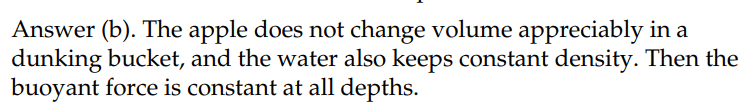

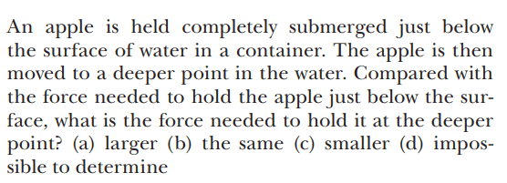

For this problem,
The solution is,
I agree with their solution from Archimedes principle, however, if I look at the equation ##PA = F##, where ##A = 4\pi r^2## and ##F## is the force over the entire apple assuming it is spherical. I thought the pressure will increase with depth and therefore I think that therefore so should the buoyancy force.
However, then I realize that the buoyancy force is due to the difference in pressure between the top and bottom of the apple assuming that the hemisphere area is the same. Therefore, since the pressure increases by the same amount assuming constant density, then the buoyancy force will be constant.
Is my alternative reasoning please correct?
Many thanks!

Yes, your alternative reasoning quoted above is correct. Buoyancy is about pressure differences, not absolute pressure.
