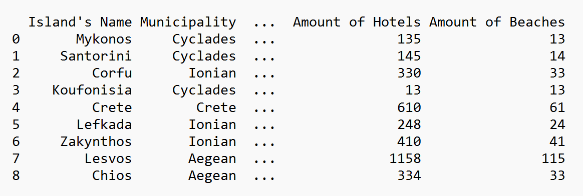

I am trying to write a code for a server in Python and I got stuck.
I gave as an input a csv file and using pandas we get a dictionary where the titles are the keys and the inputs are the values.
From that we get the below :
I have written the below endpoint to get all the islands that belog to the specific municipality :

but I get an error, I suppose that the error relates to the type of my return. I return an array of dictionaries, right? Is that not allowed? The error that I get is "TypeError: Object of type int64 is not JSON serializable".

I had to look this up but I found a couple threads on StackExhange which reference this error and they both say that this is due to the int64 type. That is a numpy type, so the fix seems to be converting it to a Python int before dumping to JSON. I would try modifying your function to something like this maybe.

Now it works properly! :geek: Does this happen because in the cvs filrthe numbers are not defined to beof type int? Or why does this happen?
So every time we have numbers in a csv file and we want to return these values we have to make them int first? :unsure:
I think so unfortunately. Here are the types that the JSON format can work with and it looks like pandas has default behavior to use int64 and float64. You could write a function to loop over your columns and column types and convert any int64 dtypes to int as well as float64 to float.
