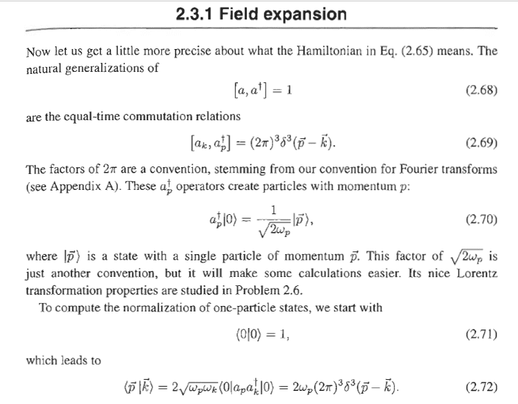

The attached pic is from Schwartz.
Can someone explain the second equality sign in (2.72)?
Use (2.69) and (2.71).
Hi that is my problem. I wasn't able to incorporate (2.69). Is there an idea?
Rewrite (2.69) as
$$\left[ a_p , a_k^\dagger \right] = \left(2\pi\right)^3 \delta \left( \vec k - \vec p \right),$$
expand the left side, and use this in (2.72).

Thank you!
