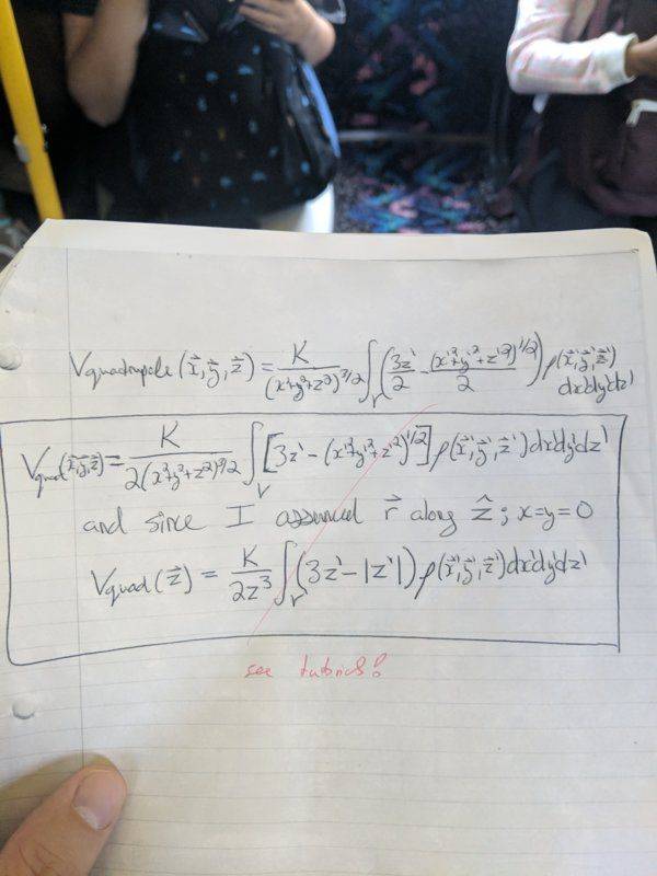

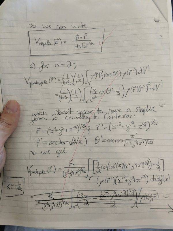

So I got an assignment returned to me with fewer marks than I had expected. One part in particular is confusing to me. The professor is only available on Monday for a tutorial, but I'd like to see what is wrong before then.
Can anyone spot why this is incorrect?

Can you write what you have done, using LaTex, and explain what your reasoning is at each step?
Actually I think I may have found the mistake as I confused a part of my notation with something that should have been unprimed. Thanks.
You have also made a mistake in writing
##P_2(\cos\theta ')=\dfrac{3}{2}\cos\theta '-\dfrac{1}{2}##.
The correct Legendre polynomial for ##n=2## is
##P_2(\cos\theta ')=\dfrac{3}{2}\cos^2\theta '-\dfrac{1}{2}##.
