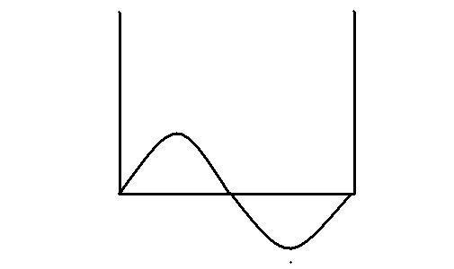

the reason i concluded that the wave function has parity because i was under the impression that the probability density of the wavefunction in a square well is anti symmetric or symmetric given the state.
Doesn't one of the excited state wavefunctions look like the diagram??
The solutions of the time independent Schrodinger equation do have definite parity with respect to the center of the well, yes. But the actual wavefunction of a particle does not have to be of any definite parity! I never implied that the stationary states had no definite parity, I only said that the wavefunction given in the above problem had no definite parity.
