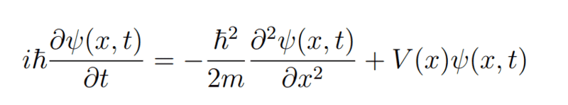

Time-dependent Schrödinger equation: iħ ∂ψ(x,t)/∂t = −(ħ²/2m) ∂²ψ(x,t)/∂x² + V(x)ψ(x,t).

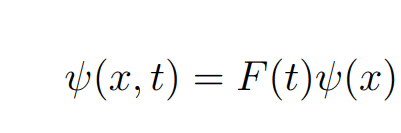

Next, we assume a solution in this form:
Equation: ψ(x, t) = F(t)ψ(x), written as a product of a function of t, F(t), and a function of x, ψ(x).
Which simplifies (according to my notes) to this:
Equation: psi(x) i hbar dF(t)/dt = F(t) [ -(hbar^2/2m) d^2 psi(x,t)/dx^2 + V(x) psi(x) ] = H psi(x)
In the middle equation, we have factorised out the F(t). My question is why is it wavefunction(x,t) rather than wavefunction(x). I first thought it was a mistake in the notes, but it uses the same equation later on.
Edit: And F(t) on the rightmost equation.
Probably just a typo. It should be ##\psi(x)##. Also, ##F(t)## is missing in the last term on the right in the last equation.
Cheers - yeah I forgot to mention that here but you're right
