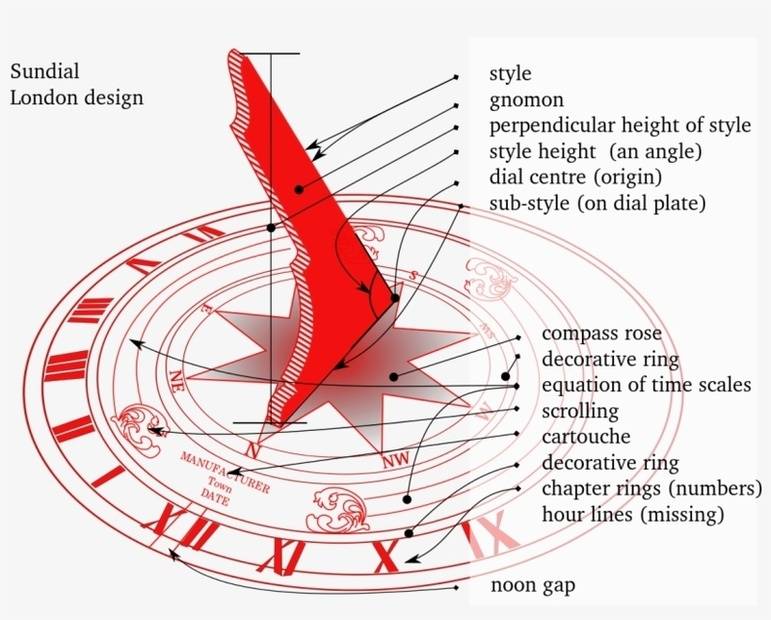

How does the height of the gnomon affect the sundial
I am curious how the height of the gnomon in a horizontal sundial is dependent on your location. Why does it need to be different high depending on where you are? Does it have to do with how high the sun is in the sky depending on the latitude you are on?

Isn't it just that you need the sloped bit of the gnomon to be parallel to the rotation axis of the Earth? Thus it makes an angle with the floor equal to your latitude.
Is angle what the OP means by "height"? I assumed the OP meant length.
But your suggestion makes much more sense.
See the fourth bullet in the diagram you posted.
Depends on whether the OP knows that, of course. Let's see what they say.

Yes, I am talking about the angle! So this has to do with the rotational axis of the earth?
Yes. If you align the style parallel to the Earth's rotation axis then the movement of the shadow is a constant rate. You can use any angle you like, in fact, but the non-uniform motion makes it harder to read the dial when the shadow isn't pointing exactly at a marking.
So what would happen if the angle is decreased? I.e. smaller than the correct one for that latitude?
I'm assuming you're asking about the vertical angle above the horizontal plane.
If that angle doesn't match the latitude, unnecessary errors will be introduced in different seasons. If the angle is wrong, and you trace out the hour lines in the spring or fall, they'll be a little in error in the summer (either too "squished up" up or too spread out) and in error in the other direction in the winter. If you want to minimize this seasonal error, ensure the vertical angle matches the latitude.
