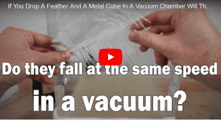

Here's an experiment to show that, once you remove air resistance, all objects have the same acceleration under the Earth's gravity. This experiment was famously carried out on the Moon by the Apollo 15 astronauts - the Moon has no atmosphere.
In general, this guy's videos are a good source for basic experimental physics.
This principle extends so that different objects will stay in the same orbit if they start in the same orbit.

Dat's a scary image, IMO:
The picture makes it look like he is doing the experiment bare-handed in a vacuum chamber, but thankfully (after I skimmed through the video), he is not. Phew!
