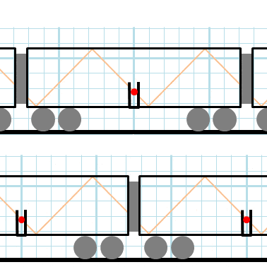

Hello everyone,
I'm reading Morins book which I like, and I feel I kind of understand the part on time dilation, however I'm a little confused by the geometry of the Pythagorian theorem when applied to velocities.
On the moving clock he shows the velocity of light on the diagonal it traces out is c, so far I understood this.
Then he says the tangential velocity is v and it makes a right triangle with c as the hypoteneus and v as the adjacent and where the vertical velocity component (opposite side of the triangle) is ##\sqrt {c^2 - v^2}##
The way I think about it is I imagine a 1 second interval, and the adjacent will trace (v * 1 second) meters, the hypoteneus will trace (c * 1 second) meters and the opposite will trace (##\sqrt {c^2 - v^2}## * 1 second) meters.
I'm wondering if my understanding is rigorous enough or maybe I need to get more rigorous?
Please let me know what you think, thank you!

Using the "one-second" trick is fair enough in this case. That shows that in one second in the ground frame, the light (being informal with units) has attained a height of ##\sqrt{c^2 - v^2} = c\sqrt{1 - v^2/c^2}##. Which is the height attained in the moving frame after ##\sqrt{1 - v^2/c^2}## seconds.
And that is, essentially, time dilation in a nutshell. The ground frame measured that it took the light one second to reach a height that represents only ##\sqrt{1 - v^2/c^2}## seconds in the moving frame.

So in the book Morin says the light clock could be constructed in its rest frame with a laser.
I'm just curious how the diagonal speed of light is c considering the vertical laser setup.
I'm thinking that the slope of the line is something like ##\frac {\sqrt{c^2 - v^2}} {v}## but I'm thinking my analysis is a little naive and I'm not sure why.
If the clock is carried horizontally at a speed v then the light will travel up and horizontally so it will have a diagonal path and the trajectory of this path should travel at speed c according to special relativities postulate.
I'm thinking that I'm maybe jumping to some conclusions here and my analysis is maybe not rigorous enough.

That one is easy: It doesn’t. And it doesn’t need to.
With the laser pointing vertically in the clock rest frame and moving at velocity v in the lab frame, the light will come out diagonally. The laser does not need to be tilted.
So if light has a trajectory the speed of light in the trajectory is always c?
Yes, that is one of Einstein’s postulates for special relativity.

The light moves diagonally in the lab frame but vertically in the clock rest frame, am I understanding things correctly?
Yes.
Yes. And since it is traveling at ##c##, but covers a longer distance in the lab frame, the light clock will be time dilated in the lab frame--one "tick" of the light clock will correspond to more than one "tick" of time in the lab frame.

So in the lab the photons are moving horizontally at v but at the same time they are moving vertically at ##\sqrt {c^2 - v^2}##
If you want to separate out components of their velocity, yes.
By the phytageoren theorem $$c^{2}=c_{{\rm horiz}}^{2}+c_{{\rm vert}}^{2}$$ thus $$(1)\quad c_{{\rm vert}}=\sqrt{c^{2}-c_{{\rm horiz}}^{2}}$$
In the frame relative to which the light clock is at rest we have ##c_{{\rm horiz}}=0## and it follows from (1): $$c_{{\rm vert}}=c$$
In the frame relative to which the light clock is moving we have ##c_{{\rm horiz}}=v## and it follows from (1): $$c_{{\rm vert}}=\sqrt{c^{2}-v^{2}}$$
