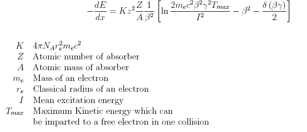

What thickness of copper is required to stop a 500 MeV/c proton?
E=(m^2+p^2)^1/2
So I have been to some websites and trying to google this- and everyone is using charts and looking of the value of the range in a material.
First, I cannot find the chart for copper and protons. I can convert the momentum to energy - but that's all I got.
How can I solve this problem? Thanks!
Did you find the Bethe(-Bloch) formula?
Yes,,,, but how the heck am I suppose to use this formula??
There has to be got like a two line solution here for such a simple problem no?

Hmm... So what is the variable I am trying to solve for then ? I want the thickness of copper so that has an Atomic mass: 63.546, and 29 Protons - So i have my A and Z.
and Tmax, I and the delta function.. What am I suppose to do with this. And even if I do plug everything in then I get -dE/dx...The derivative of E with respect to x. Is that what I want ?!?

But I don't see an x in that equation, and I have no idea what beta, Tmax, I or how to use the delta function for that is. So I don't have all the values... very very confused, can you help me with step one? Just setting up the equation.
Left side, in the denominator.
If dE/dx would be a constant 10 MeV/cm, then your protons would have a range of 50cm, for example.
For the other values, there are typical values you can use. That won't be exact, but a good approximation.
