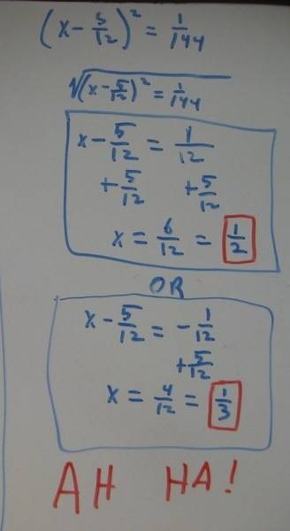

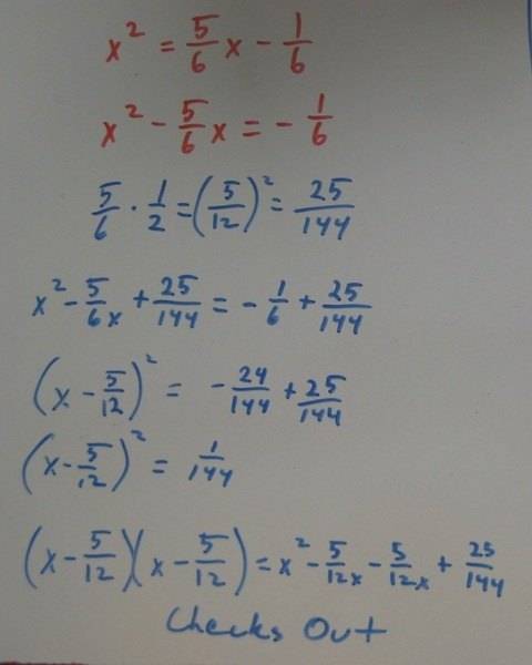

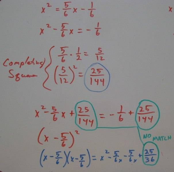

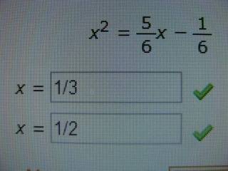

Alright so the solution is in the above pic, but I can't get anywhere close. You can see from the green circles that the "squares" aren't matching up. So I'm not sure if I can't multiply fractions anymore or what.

Your line
[itex]\displaystyle x^2-\frac{5}{6}x+\frac{25}{144}=-\frac{1}{6}+\frac{25}{144}[/itex]
is correct.
What your last line shows (correctly) is that [itex]\displaystyle \left(x-\frac{5}{6}\right)^2\ne x^2-\frac{5}{6}x+\frac{25}{144}\ .[/itex]
When you square 5/6, you don't get 25/144 .
How did you get 25/144 in the first place? You squared 5/12 not 5/6 .
you went from
[itex]x^2 +bx + (\frac{b}{2})^{2}[/itex]
to
[itex](x+b)^{2}[/itex]
and not to
[itex](x+\frac{b}{2})^{2}[/itex]
Hellllllll I've been doing it wrong for centuries then. Let's try this again.
Ahhhh! Thanks for the help guys! I was always just dropping the last number off and went with the first 2. Guess I never caught on that fractions didnt work that way.
