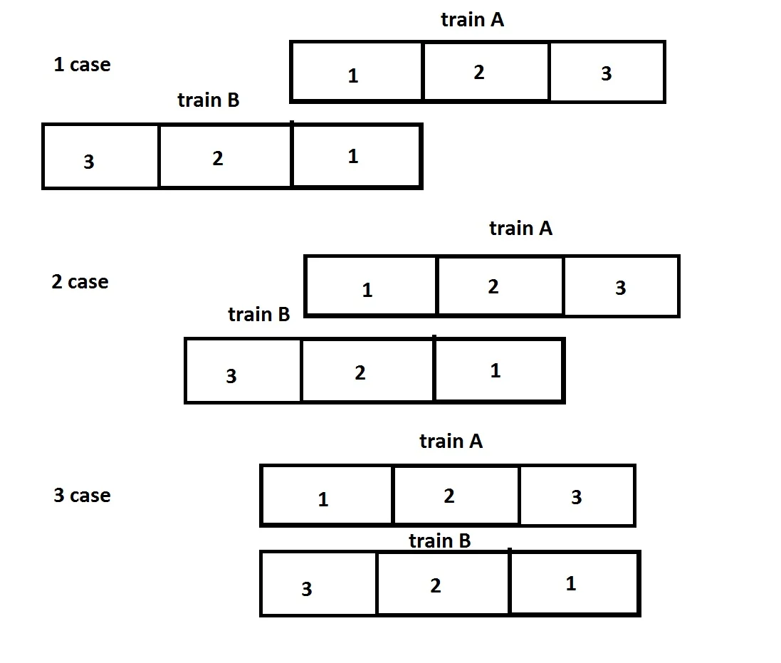

It usually helps immensely in describing a scenario by drawing it. Even a very basic one. :)
Three cases of two trains passing, each with train A on top and train B below, carriages numbered 1 to 3 in opposite orders: case 1 with train A's 1 aligned with train B's 1, case 2 with A's 1 at B's 2 position, and case 3 with A's 2 aligned with B's 2.
case 1 : Train A carriage 1, Train B carriage 1: 0sec, 0sec (clocks are synchronized)
case 2 : Train A carriage 1, Train B carriage 2: 2sec, 1.9sec
Train B carriage 1, Train A carriage 2: 2sec, 1.9sec
case 3: Train A carriage 2, Train B carriage 2: - ?
Mike_bb said:
Passenger see another passenger in the window of carriage. The clocks are synchronized as I mentioned above in my post #1.
Presumably at all times any passenger can look out the window and see all of the carriages on the other train. So every passenger will record all possible times of all the carriages on the other train.

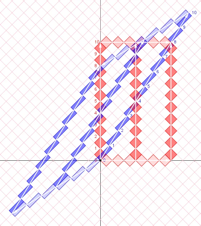

Here's a spacetime diagram drawn on rotated graph paper.
(All light-clock-diamonds have the same area
and all light-clock-diamonds have lightlike edges, by Lorentz invariance.)
Note that, in addition to time-dilation,
there is length-contraction and relativity-of-simultaneity
(which are not as easily represented on your spatial boxcar drawings).
I chose nice numbers to make the arithmetic simple.
Let Bob travel at (3/5)c to the right on Alice's diagram,
with boxcars spaced (for convenience) 3 of Bob's sticks apart.
Alice is at rest, with boxcars spaced identically with 3 of Alice's sticks.
When the trains first meet, the lead clocks read 0.
In Alice's frame, when her clock reads 0, all of Alice's boxcar-clocks also read 0.
In Bob's frame, when his clock reads 0, all of Bob's boxcar-clocks also read 0.
I think you should be able to read off all of the clock readings when the various boxcars meet.
Spacetime diagram on rotated graph paper showing two sets of boxcar clocks as red and blue diamond lattices, with blue diagonal lines marking Bob's moving frame and clock readings 0 to 10 labeled along the axes.
Notice a bunch of Minkowski-right-triangles similar to
a 3-5-4 Minkowski-right-triangle [which is characteristic of relative-velocity (3/5)c].
Notice that, for v=(3/5)c, the Doppler factor is k=2.
The Doppler factor is an eigenvalue of the Lorentz boost.
So, to get Bob's diamond from Alice's diamond,
stretch by k=2 along the forward future-lightlike direction, and
shrink by k=2 (to preserve area) along the backward future-lightlike direction.

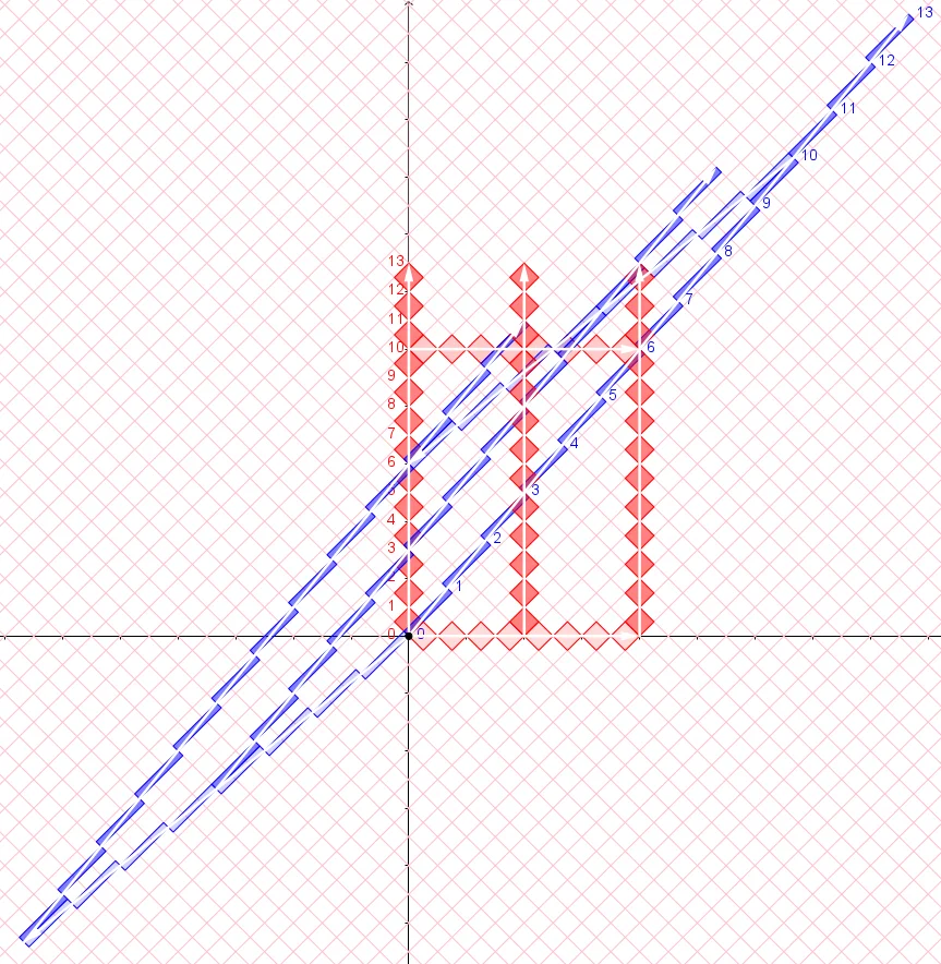

And here's the (4/5)c case, with boxcar spacing 4 sticks,
4-5-3 Minkowski-right-triangles, and Doppler k=3.
Spacetime diagram on rotated grid: two sets of red diamond-shaped light clocks forming grids, with blue lightlike lines and tick labels 0 to 13 along the axes.
These spacetime-diagrams on rotated graph paper are essentially
"spacetime-diagrams decorated by the light-signals in a ticking light clock",
which provide a construction for doing graphical calculations in special relativity.
