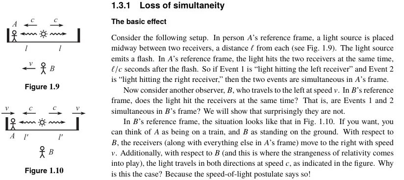

A simple explanation of the relativity of simultaneity is given in Morin's book "Special Relativity: For the Enthusiastic Beginner", chapter 1.3.1
Event 1 is “light hitting the left receiver”
Event 2 is “light hitting the right receiver”
In A's reference frame, E1 and E2 happen simultaneously.
In B's reference frame, E1 happened before E2 happens.
source:
https://davidmorin.physics.fas.harv...nuum12331/files/2025-10/relativity_chap_1.pdf
via:
https://davidmorin.physics.fas.harvard.edu/books/special-relativity

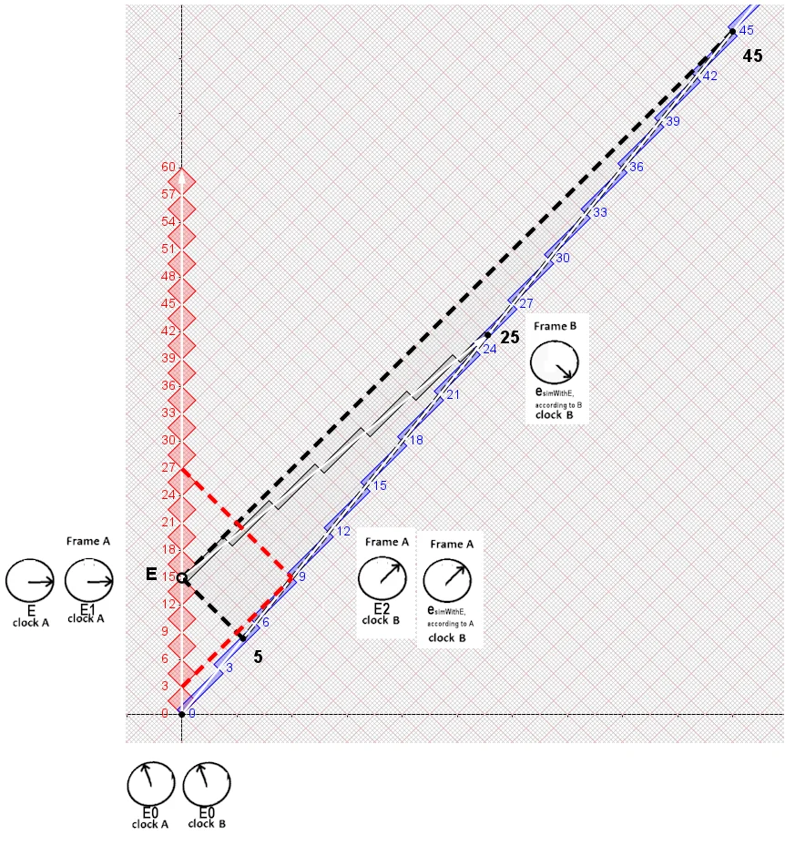

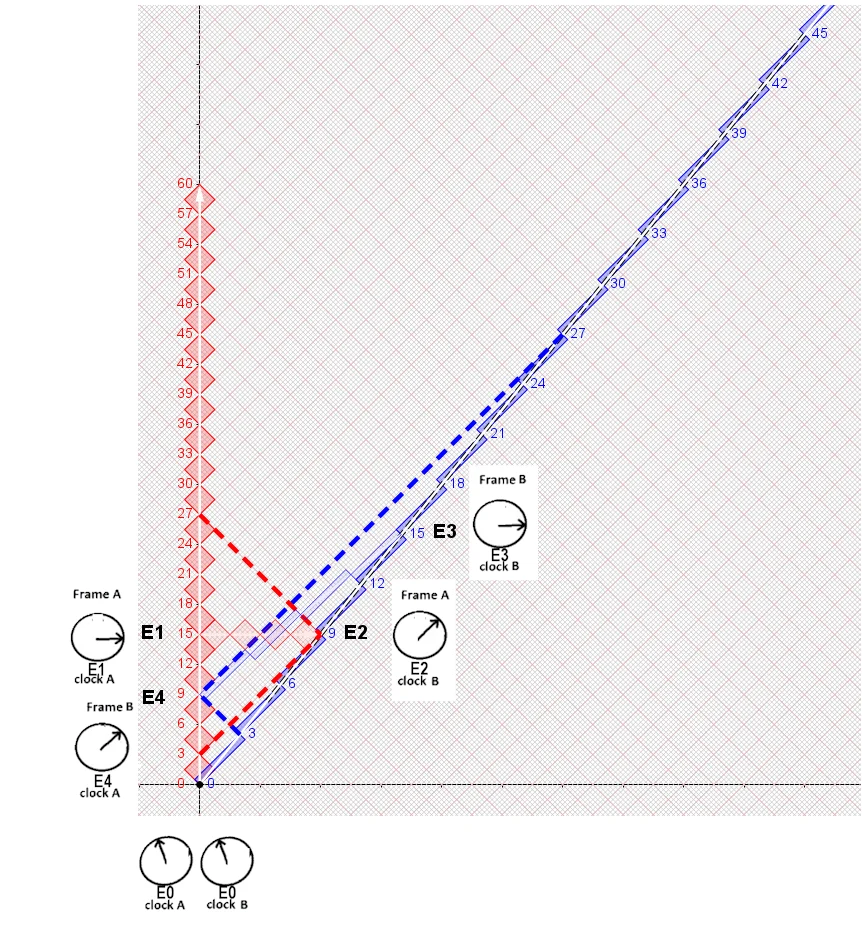

Mike_bb said:
Case 1) Reference frame: A
E1: clock A shows 100s
E2: clock B shows 80s
Case 2) Reference frame: B
E3: clock B shows 100s
E4: clock A shows 80s
I think you need to write out...
  • I'm going to use "reads" to avoid possible misinterpretations
    when using anything suggesting what it "visually looks like".
According to observer A, E1 (clock A reads 100) and E2 (clock B reads 80) are simultaneous.
According to observer B, E3 (clock B reads 100) and E4 (clock A reads 80) are simultaneous.
  • Agree

This is nice example. Thanks! But for our example you wrote that:
With reference to Observer B's rest-frame:
Clock B first shows 80s (E2) and 20s later clock B shows 100s (E3). Clock A shows then 80s.
From frame B: clock B shows 100s(E3), clock A shows 80s. Then clock A shows 100s, clock B shows 125s. But E1 (clock A shows 100s), E2(clock B shows 80s). 125s isn't equal to 80s.
Where did I go wrong? THx.
You missed the relativity (=frame-dependency) of simultaneity. See posting #50.
With reference to frame B the events [clock B = 100s] and [clock A = 80s] happen simultaneous to each other.
With reference to frame A the events [clock B = 100s] and [clock A = 125s] happen simultaneous to each other.
Yes, I agree with this, there is no contradiction. But why did you write about these events? I asked about that from frame B clock A shows 80s (as you mentioned in post#50) then clock A shows 100s. Which time does clock B show?
  • Sad
With reference to frame A the events [clock A = 100s] and [clock B = 80s] happen simultaneous to each other.
That's the point, [clock A = 100s] and [clock B = 80s]. I suggest following simultaneously events:
With reference to frame B the events [clock B = 125s] and [clock A = 100s]. Such way we have a contradiction because [clock A=100s] and [clock B=80s] are simultaneously events but [clock B = 125s] and [clock A = 100s] are also simultaneously events. How to be in this case?
  • Sad
With reference to which frame is the highlighted statement valid?
frame A
  • Agree
Mike_bb said:
frame A
That means there is no contradiction, analog to what you wrote in posting #73:
  • Agree

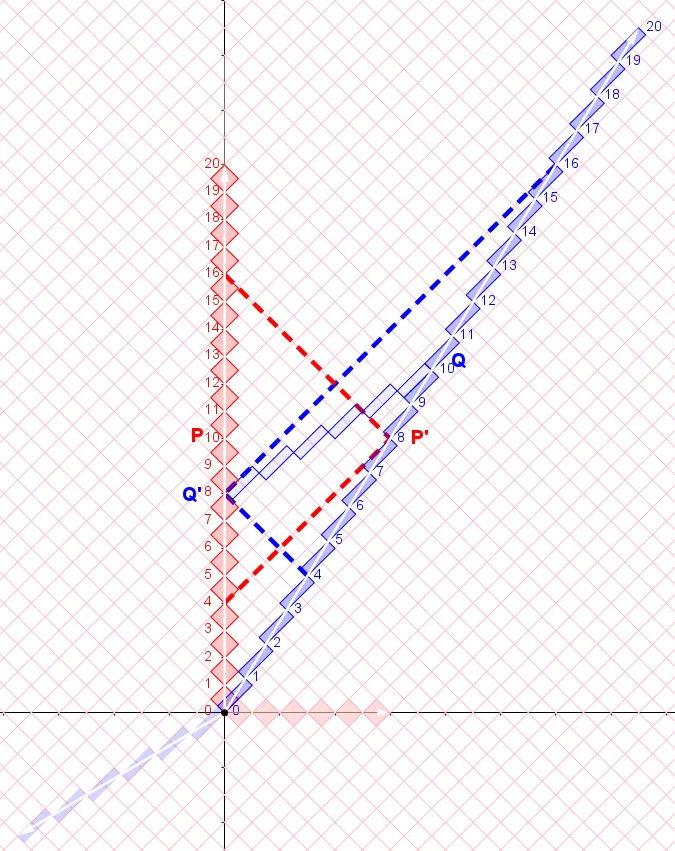

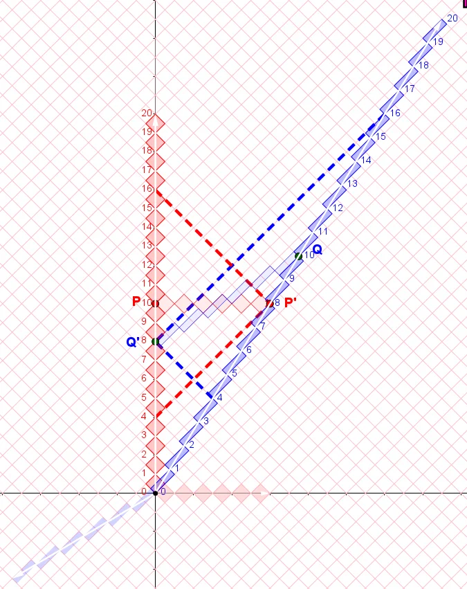

Here's my graphical attempt to help you @Mike_bb .
After a summary-and-diagram,
there is a second diagram with an exercise for you to do.
First, here's a simplified summary of radar measurements by Alice (in red) and by Bob (in blue).
  • Let P' be the event "[on Bob's worldline] Bob's wristwatch reads 8".
    So, ##t_{P',{\rm says\ Bob}}=8##.
    Alice assigns coordinates to distant-event P'
    by sending the appropriate light-signal (when her watch reads ##t_s=4##) to reach P'
    and waiting to receive its echo (when ##t_r=16##).
    She assigns the time ##t_{P',{\rm says\ Alice}}=(16+4)/2=10##.
    Alice says the midpoint-event P ("[on Alice's worldline] Alice's wristwatch reads 10")
    is simultaneous with distant-event P' ("[on Bob's worldline] Bob's wristwatch reads 8").
  • Similarly (swapping Alice and Bob, and Ps and Qs),
    Let Q' be the event "[on Alice's worldline] Alice's wristwatch reads 8".
    So, ##t_{Q',{\rm says\ Alice}}=8##.
    Bob assigns coordinates to distant-event Q'
    by sending the appropriate light-signal (when his watch reads ##t_s=4##) to reach Q'
    He assigns the time ##t_{Q',{\rm says\ Bob}}=(16+4)/2=10##.
    Bob says the midpoint-event Q ("[on Bob's worldline] Bob's wristwatch reads 10")
    is simultaneous with distant-event Q' ("[on Alice's worldline] Alice's wristwatch reads 8").

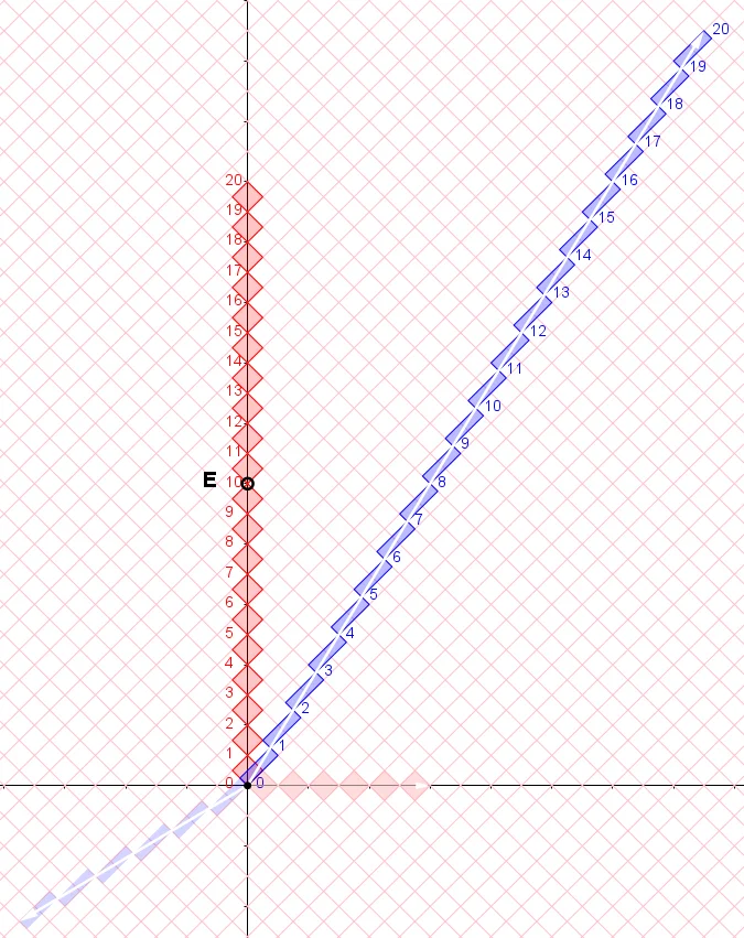

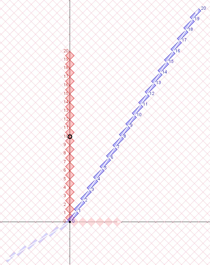

Important exercise
Consider the event E "[on Alice's worldline] Alice's watch reads 10".
Use the radar construction on the diagram below to answer
  1. What event on Bob's worldline does Alice regard as simultaneous with E?
  2. What event on Bob's worldline does Bob regard as simultaneous with E?
View the next line after finishing the construction.
For the event E "[on Alice's worldline] Alice's watch reads 10",
Alice regards the event "[on Bob's worldline] Bob's watch reads 8" as simultaneous with E,
whereas
Bob regards the event "[on Bob's worldline] Bob's watch reads 12.5" as simultaneous with E.
Alice would choose the event on Bob's worldline such that
"its associated send-and-receive-pair-of-events has midpoint-event as E (which is on her worldline)".
- One could search: does the reflection-event associated with (say) 9-and-11 meet Bob's worldline? If not, try 8-and-12, etc...
- Alternatively, one could pick an arbitrary event on Bob's worldline, then note the associated send-and-receive-pair-of-events on Alice's worldline. If its midpoint-event isn't E, try another event on Bob's worldline. (Think "similar triangles".)
Bob would choose the event on Bob's worldline such that
it is the midpoint-event of the "send-and-receive-pair-of-events associated with E (which is not on his worldline)".
- Draw the lightcone-of-E (just the light-signals from E) and note the intersection-events with Bob's worldline.

Just a postscript...
(thanks to a mentor for re-opening this to allow me to make this hopefully-helpful comment)
Since the OP recently posted a simiilar question at https://physics.stackexchange.com/q...t-time-7sec-and-15sec-reciprocal-time-dilatio )
and drew some clock faces, I thought the following spacetime diagrams (using a variant of the values in the SE post)
with those clock faces might help @Mike_bb.
Here are those diagrams.
Here the clock-readings are 15 and 9 (instead of 15 and 7 from SE and 100 and 80 here at PF).
and then here is the answer to the early exercise using 15 and 9:
The point of these diagrams is to say there is no situation (no spacetime event)
where a clock has two different readings.
The events E1 and E4 are distinct. The events E2 and E3 are distinct.
It is important to note that "events on a spacetime diagram" are like "points on a blackboard".
Events do not belong to frames-of-reference, to inertial-observers.
Events, however, may be local or distant with respect to a given observer.
It could be, however, that some event is of more interest to an inertial-observer, as opposed to another inertial observer.
In particular, in the exercise, consider the event E on Alice's worldline.
These two events on Bob's worldline are different events, corresponding to different clock-face readings of Bob's clock.
So, these two events and thus clock-face readings are distinct.
They do not coincide.
They never happen together.
I hope this helps.
