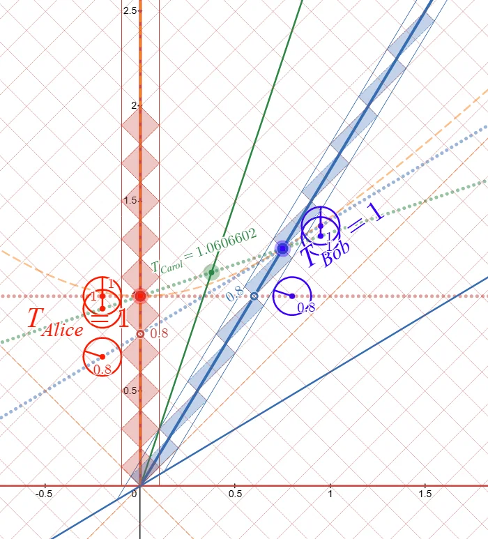

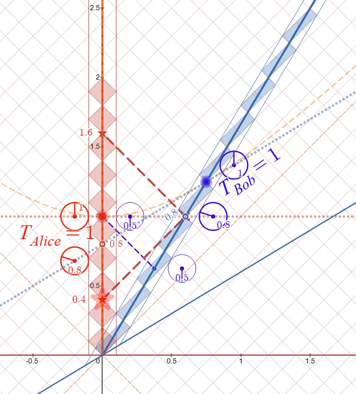

Hello, PF!
I just understand that people couldn't fully understand me in my old topic because many terms in English have another senses in Russian and vice versa. Because of the language barrier I couldn't explain what I meant. Moreover, my vocab is poor and I speak English badly. Please, sorry me!
Now I'll try to explain what I want to find out but I don't know if people will understand me correctly.
I have an example on the Russian. It sounds like this:
1) If observer A will look at the clock B then he will see that clock B is running slowly. E1: clock A = 100sec, E2: clock B = 80sec
2) If observer B will look at the clock A then he will see that clock A is running slowly. E3: clock B = 100 sec, E4; clock A = 80 sec
My question is: How is it possible that the clock B can read two different values (slowed time (80sec) and proper time (100sec))?

They are. All four of your nunbered events are distinct. Your problem is that you keep thinking of "at the same time" as if it were an absolute truth. But it isn't.
Train yourself to say "at the same time according to A's rest frame" (or B's, or the primed frame or whatever) and never exclude the italicised bit. When you've learned to do that you'll be able to see immediately what the solution to your problem is, which is:
  • E1 and E2 are simultaneous according to A's rest frame
  • E3 and E4 are simultaneous according to B's rest frame
When you stop thinking of "simultaneous" as a concept the frames must share, the apparent contradiction goes away. Relativity still has a sense of causality, but it has more flexibility than pre-relativistic physics.

If you compare two clocks on the fly, you'll see that both clocks show 100sec.
Matterwave,
Let we have frame C with stationary clock C that shows some time. Compare clocks A , B on the fly at the time of clock C. We see that both clocks A , B show the same time in accordance with Postulate 1.
A more clear way to say this is:
In observer A’s frame clock B is running slowly. E1 (clock A = 100 s) is simultaneous with E2 (clock B = 80 s) in A’s frame.
In observer B’s frame clock A is running slowly. E3 (clock B = 100 s) is simultaneous with E4 (clock A = 80 s) in B’s frame.
Every clock reads different values at different events. That is what a functioning clock does. Why do you think it is a problem for a clock to read 80 s at one event and then to read 100 s at a later event?
This is an incomplete statement. In which frame will both clocks read 100 s? There is a frame where this is true, but it is neither A’s frame nor B’s frame.
No more incomplete statements, please. Any time you compare clocks you must state the reference frame.
As stated, this is not true.
A correct statement would be "according to a frame in which both clocks are moving at the same speed (possibly in different directions), if both clocks were started simultaneously according to this frame they will always read the same time, which will be lower than the time elapsed according to clocks at rest in this frame". Other frames will not describe the circumstances this way.

Yes you can. Simply state the reference frame in each sentence that you compare times on two different clocks. This is not a language issue. You have done it occasionally. You just need to do it consistently.

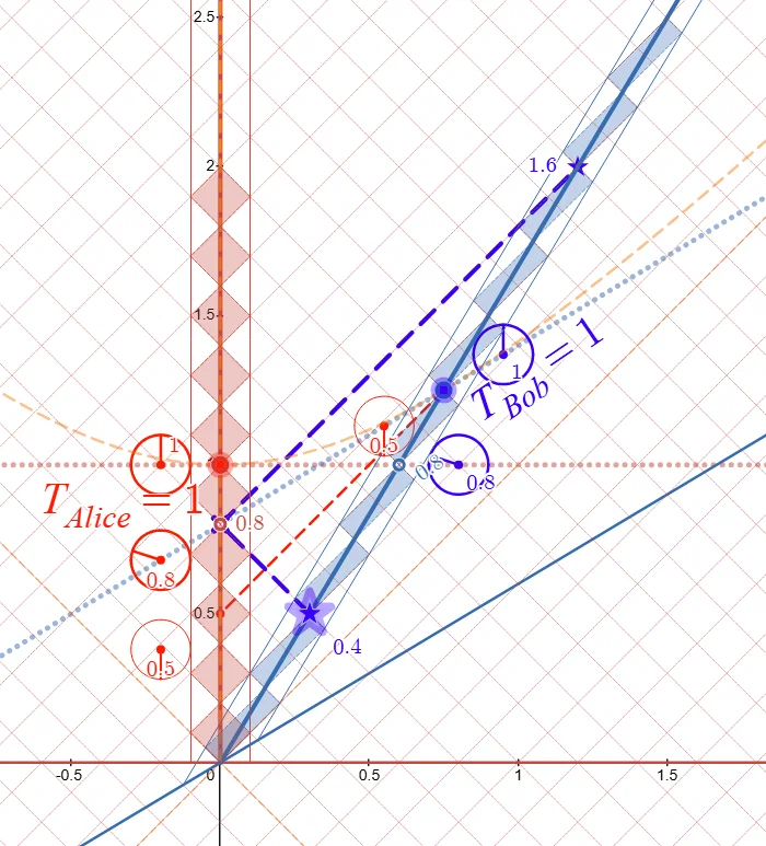

Thanks to all! I catch an insight and now I understand how reciprocal time dilation works!
Strong suggestions:
  • The position-vs-time graph of a situation (also known as a spacetime diagram)
    [like the ones I have been drawing] tells a story of the situation
    that is often more clear than a series of casually written sentences.
    - In relativity, as you have been reminded, sentences must be stated clearly and completely.
    Assumptions based on our everyday common-sense based on Galilean physics can't be assumed.
    Spell out the details, although it may seem tedious to be unambiguous.
  • Minkowski's idea of spacetime was developed by the mathematician Minkowski in 1907, a few years after Einstein's 1905 papers. I think this helped Einstein's special relativity gain more acceptance. It makes Einstein's ideas more tangible and provides a geometric framework one can use to scaffold a developing intuition.
  • I think you need to learn to express your situations using spacetime diagrams.
    I personally use spacetime diagrams more than textbook formulas for time dilation, length contraction, Lorentz transformation, etc... often because the word problem, the symbols (prime vs unprime), etc... are unclear to me until I draw a spacetime diagram. Even then, I analyze the diagram as a geometric problem in hyperbolic trigonometry. If needed, I translate into the textbook formulas (after I decode the notations used in the context of the problem).
    (For optics, I draw ray-tracing diagrams first, then translate into a textbook formula after I decode the notations.)
  • It takes practice to translate back and forth between words and spacetime-diagrams. Practice!

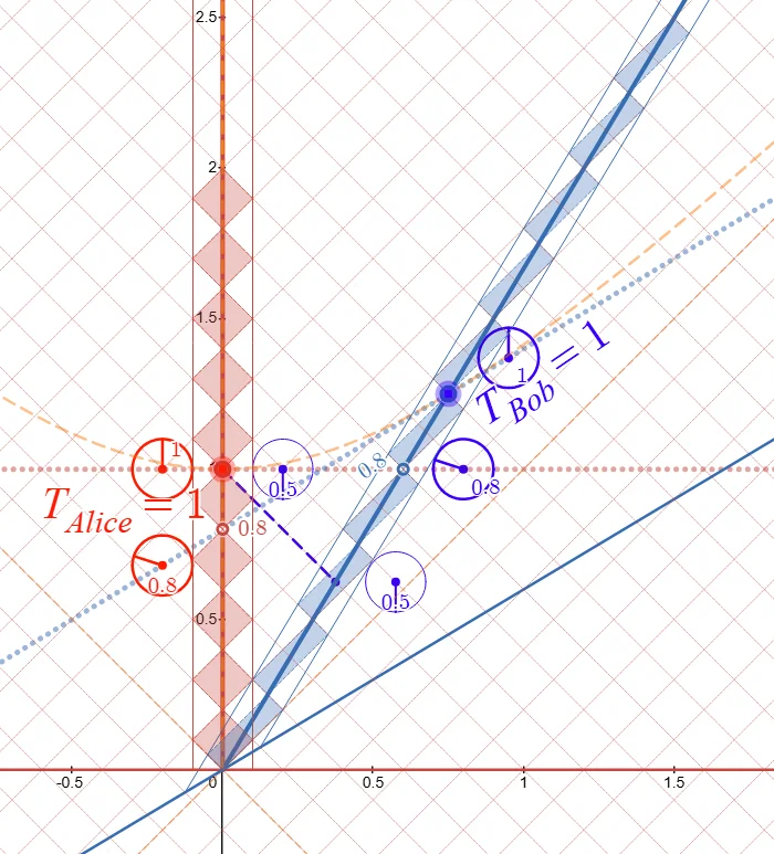

Mike_bb said:
I've thought about it and I conclude that clock B (or clock A) never read slowed time.
This is wrong, and we can try one more time to explain why
Using the frame in which A is at rest, events E1 and E2 are simultaneous - that's what A means when they say that B is running slowly. But when we use the frame in which B is at rest, we find that E1 and E2 are not simultaneous. Instead E2 and another event E5 (A's clock reads 64) are simultaneous. That's how both can conclude that the other clock is running slow.
So far you haven't involved proper time at all, but there are some proper times: proper time between E1 and E4 is 20 seconds, proper time between E2 and E3 is 20 20 seconds, proper time between E1 and E2, E1 and E3, E3 and E4 is undefined because we're comparing different clocks.

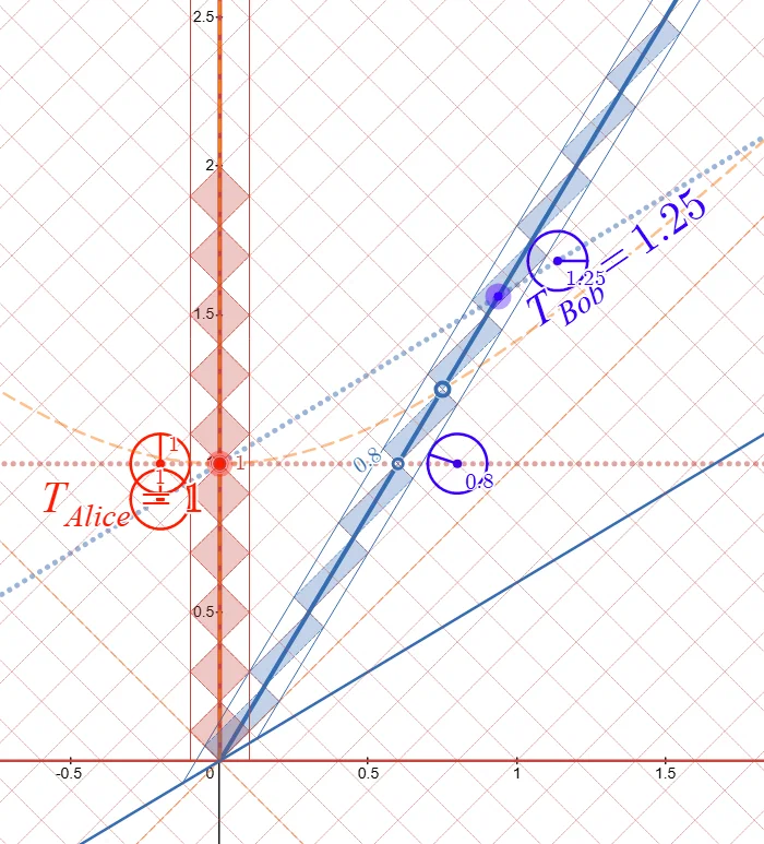

I don't think this is true. You're asking the same question here that you asked in your previous threads (of which there have been more than one), and we understood it just fine in those threads, and we understand it just fine here:
The answer is that clock B does not read different values at the same event. There is an event where clock B reads 80 sec. There is an event where clock B reads 100 sec. These are two different events. The second event occurs after the first in any frame.
Until you grasp what I have just said, and realize that the question you keep asking is based on a false premise, we are never going to get anywhere. Many of our best PF experts on this topic have been extremely patient in trying to get across to you that your question is based on a false premise. But you still don't appear to get it.
Note that everything I've just said relates to clock B's proper time. Which is not the same as coordinate time in any frame in which clock B is not at rest. That is another point which we are not sure that you understand, and you need to.

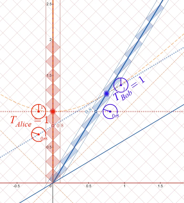

Observers at separate locations moving relative to each other just can't look at each other's clock and decide whether they run slow or fast. The best they can do is to communicate with each other by radio at the speed of light and report to each other what their onboard clock reads.
However, if they have a basic understanding of special relativity, they can calculate where the other person is and what the other person's clock reads at that position. So let's do some sample calculations that pair positions and times using the Lorentz transformation equations $$\begin{align} & x'=\gamma\left(x-vt\right)~;~~~t'=\gamma\left(t-\frac{vx} {c^2}\right) \nonumber \\

So, here are some diagrams from the Desmos script,
drawn by inertial-observer Alice, with inertial-observer Bob traveling with (3/5)c with respect to Alice.
(I would prefer to use "wristwatch" throughout,
but I see I often wrote "clock"... so treat them as equivalent.)
  • FIG 1 (Using the event labeling from an earlier thread)
    The event E1 "Alice's wristwatch reads 1 second" is simultaneous-according-to-Alice with
    the event E2 "Bob's clock reads 0.8 seconds".
    The event E3 "Bob's clock reads 1 second" is simultaneous-according-to-Bob with
    the event E4 "Alice's clock reads 0.8 seconds".
    Although the results "the other clock reads 0.8 when mine reads 1.0" are the same,
    we have four distinct events:
    a pair simultaneous-according-to-Alice (E1 and E2) and another pair simultaneous-according-to Bob (E3 and E4).
    These distinct have four different clock-faces: 0.8 and 1 on Alice's red clock and 0.8 and 1 on Bob's blue clock.

  • FIG 2: "the exercise" from my last posts in https://www.physicsforums.com/threads/how-does-reciprocal-time-dilation-work.1085952/page-3
    What event on Bob's worldline does Alice regard as simultaneous with E?
    What event on Bob's worldline does Bob regard as simultaneous with E?
    The event "Bob's clock reads 0.80" is simultaneous-according-to-Alice with
    the event "Alice's clock reads 1".
    The event "Bob's clock reads 1.25" is simultaneous-according-to-Bob with
    (Drag the T_Bob event from T_Bob=1 to T_Bob=1.25.)
  • FIG 3: "Seeing" (Doppler) vs "Calculating" (simultaneity)
    Although we had (from FIG 1)
    the event E1 "Alice's wristwatch reads 1 second" is simultaneous-according-to-Alice with
    the event E2 "Bob's clock reads 0.8 seconds"---by a calculation (e.g. radar, as shown below in FIG 4) or by registration by a clock-in-her-lattice,
    what Alice [optically] sees (views) is
    the image [signal] of
    the event "Bob's clock when it read 0.5 seconds".
    (This is essentially the Doppler effect,
    ##k=\frac{T_{\rm reception\ period}}{T_{\rm emission\ period}}=\frac{1.0}{0.5}=2##,
    which is expected for ##v=(3/5)c## used in ##k=\sqrt{\frac{1+(v/c)}{1-(v/c)}}##.)
    • This is why, when referring to simultaneity or the assignment of (t,x)-coordinates,
      "views" or "sees" is possibly ambiguous.
  • FIG 4: "Seeing" (Doppler) vs "Calculating" (simultaneity)
    by a radar measurement of E2.
    For Alice to measure (assign coordinates) to event E2,
    she must send a signal at ##t_{send}=0.4## and
    wait for its echo to be received at ##t_{receive}=1.6##.
    So Alice assigns to E2:
    ##\Delta t=\frac{1}{2}\left( t_{receive}+ t_{send} \right)=1.0## and
    ##\frac{\Delta x}{c}=\frac{1}{2}\left(t_{receive}-t_{send} \right)=0.6##.
  • FIG 5: Of course, by the Relativity Principle [for these inertial observers],
    Bob will have the same measurements of Alice.

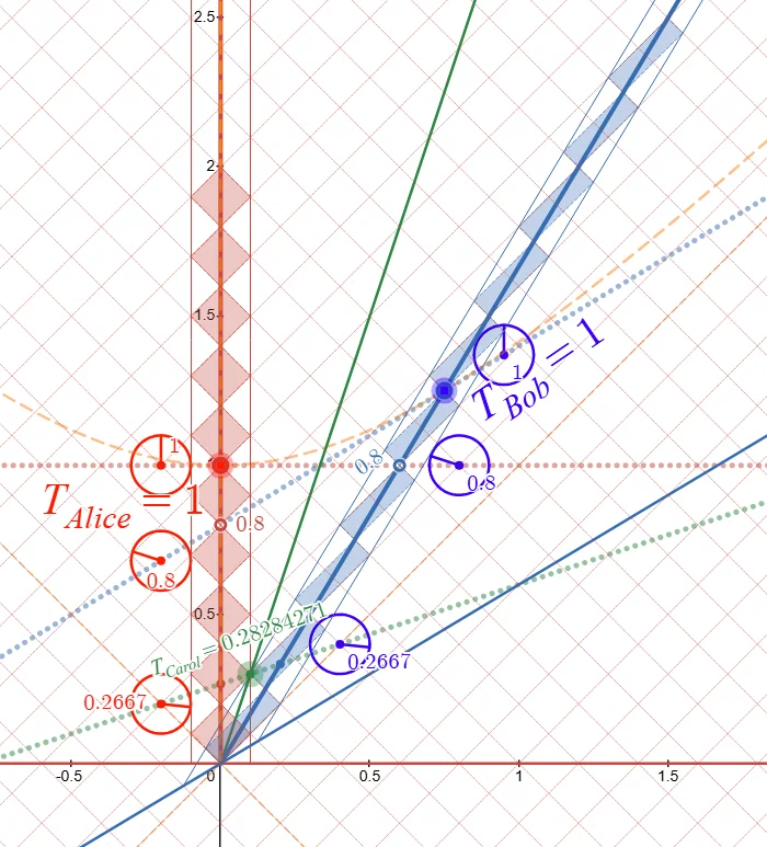

  • FIGS 6 and 7: It may be enlightening to introduce Carol, an inertial-observer in the median frame
    (akin to the direction along the angle-bisector).
    ##v_{Carol}/c=\tanh\left( \frac{{\rm arctanh}(v_{Alice}/c) + {\rm arctanh}(v_{Bob}/c)}{2} \right)##.
    In Carol's frame, Alice and Bob are traveling in opposite directions with the same speed.
    In Carol's frame, Alice and Bob clocks read the same time,
    although this time is smaller than Carol's clock time.
    • According to Carol,
      the event when "Carol's clock reads 0.2828s" is simultaneous-according-to-Carol
      with the event "Alice's clock reads 0.2667" and with the event "Bob's clock reads 0.2667",
      as these events are on a line parallel to the spacelike diagonal of Carol's light-clock-diamonds.
      the event when "Carol's clock reads 1.0606" is simultaneous-according-to-Carol
      with the event "Alice's clock reads 1" and with the event "Bob's clock reads 1",
