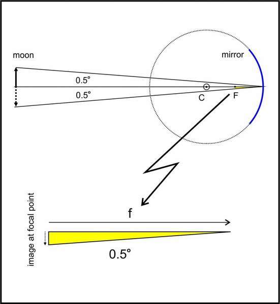

When viewed from Earth, the Moon subtends an angle of 0.5° in the sky. How large an image of the Moon will be formed by the 3.6 m diameter mirror of the Canada-France-Hawaii Telescope, which has a focal length of 8.5 m?
1/s + 1/s' = 1/f, but I'm not sure what else.
I'm really not sure where to begin. My book only talks about refracting telescopes and we've yet to talk about reflecting telescopes in class. I thought initially it might have something to do with the distance to and radius of the moon but I couldn't figure out how to work those into the problems. I'd appreciate any help you have. Thanks!
The angle the object subtended at the mirror is the same angle that the image subtends - just like for refracting telescopes.
