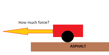

This is a simple system. Assume the weight is completely balanced on the wheel (not going to tilt to any direction). the weight (red block) weighs 200 kg. the wheel (2 of them) each weighs 4 kg.
how to calculate:
1. the minimum force needed to get the weight moving
2. total energy needed to get the system to move 2m from point of origin
3. as I understand it, the friction coefficient of 2 things in contact is not always constant. so, I;m not sure how to get this one metric.
Thanks

I can only see the first of your three drawings and this shows a cart on wheels. So my answer is based on just that drawing...
The force required to start it moving will depend on the rolling resistance of the wheels plus any friction in the bearings. Normally friction in the bearings can be ignored (if they are good bearings).
https://www.engineeringtoolbox.com/rolling-friction-resistance-d_1303.html
If you want it to accelerate you also need to include inertia.
Friction between the tyre and ground won't really come into it unless the wheel brakes are on causing the wheels to skid.

ok, so, assuming that they're good bearings (negligible friction), using the coefficient from the car on asphalt example (because the tire used in the diagram will be car tires with pressure 40 psi or 2.76 bar with speed of 0.2 km/h), the calculation becomes:
c = 0.005 + (1 / 2.76) x (0.01 + 0.0095 x (0.2/100)2) = 0.0087
so, the force needed to pull 200kg is
F = 200 x 9.8 x 0.0087 = 17.052 N ~ lifting a 1.7kg weight
is this correct? I mean, it would take so little effort to move 200kg on wheels with good bearings?
btw, no torque calculation involved in this?
thanks

If it was perfectly balanced when at rest, and stays balanced when the force is applied, the force will have to be applied at just the right height.
Now about this inertia: if you want to accelerate 208 kg to 200 m/h = 1/18 m/s you need some force too. Say you want to do this with a constant force over the full 2 m. Then Force * displacement = kinetic energy yields a puny extra required force of 0.16 N.
And note that with a 1 cm height difference from a loose tile your required force to overcome that jumps up considerably !
Or at the correct angle.

From the link I posted above the rolling resistance or force required to pull 200kg is simply
F = c W
where c = 0.02 (from the table)
W= 200 * 9.81 = 1,962 N
so
F = 0.02 * 1962 = 39N
Not too far off your figure.

so, for this case, there's no static or kinetic coefficient? just 1 rolling coefficient
True, but the diagram shows it as horizontal.
