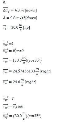

Question 2:A golf ball is hit from 4.3 m above a golfing fairway with an initial velocity of 30.0 m/s at an angle of 35° above the horizontal.
A. Determine the time of flight for the ball.
B. Determine the range for the golf ball.
C. Determine the velocity for the golf ball the instant before the ball impacts the ground.
Pythagorean theorem equations
Handwritten physics solution part a: displacement Δd_y = 4.3 m [down], acceleration a = 9.8 m/s² [down], initial velocity v_i = 30.0 m/s [up]; then v_ix = v_i cos θ = (30.0 m/s)(cos 35°) = 24.6 m/s [right]; v_iy = v_i sin θ = (30.0 m/s)(sin 35°).

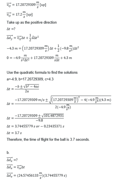

Handwritten-style kinematics working on a projectile problem: vertical velocity values, a displacement equation solved with the quadratic formula to give t = 3.7 s, and a horizontal range calculation beginning Δd_x = v_x Δt.

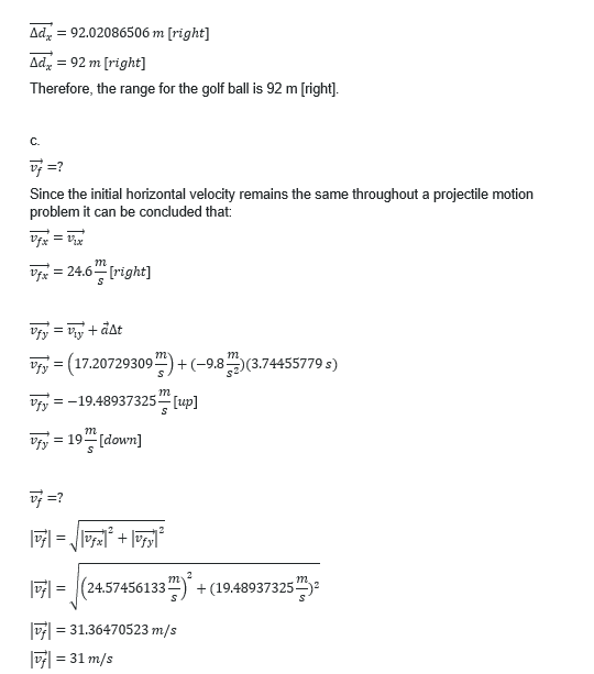

Handwritten-style worked solution of a projectile motion problem showing range 92 m right, horizontal velocity 24.6 m/s right, vertical velocity 19 m/s down, and final speed 31 m/s.
Handwritten-style typed working: tan θ = |v_fy| / |v_fx|, then tan θ = 19.48937325 m/s / 24.57456133 m/s, θ = tan⁻¹ of that ratio, θ = 38.41691594°, θ = 38°, followed by the line: the ball is moving towards the right and downwards, and the velocity is 31 m/s [right 38° down].
It seems that you have a complete solution. Is there a question you wish to ask or are you posting a solution for the benefit of others?
kuruman said:
It seems that you have a complete solution. Is there a question you wish to ask?
I was wondering if someone could look over the steps to ensure I'm on the right track and provide me with any feedback!
Is this your solution or someone else's? If yours, it looks professional. I have not put in the numbers, but it looks right.
This is my own attempt at a solution for the question asked above
See edited post #4. If you wish to check your work, plug in the time of flight in the kinematic equations and see if the ball lands where you thought it would be.

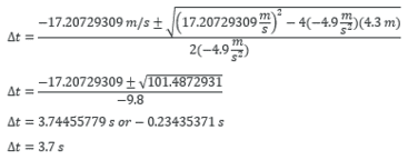

Arithmetic errors creep in here:
Handwritten-style working of the quadratic formula solving for time, starting from Δt = (-17.20729309 m/s ± √((17.20729309 m/s)² - 4(-4.9 m/s²)(4.3 m))) / (2(-4.9 m/s²)), then Δt = (-17.20729309 ± √101.4872931) / -9.8, giving Δt = 3.74455779 s or Δt = -0.23453371 s, and finally Δt = 3.7 s.
but they do not affect the final results to 2sf, and otherwise it looks good.
