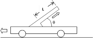

A rolling projectile launcher is initially at rest. Then internal compressed air accelerates the projectile through a distance L in a pipe (see diagram). The acceleration of the projectile with respect to the pipe is ap. During the launch the launcher has a recoil acceleration ar with respect to the ground. Both accelerations are constants. Use the data given below and calculate the velocity, with respect to the ground, of the projectile as it leaves the pipe.
Data: L = 2.00 m, theta= 53.0, ap = 36.0 m/s2. ar = 15.0 m/s2

I have never seen anything like this before. However, I tried setting up it up like a projectile motion problem with what I knew
Xo=0 Yo=0 because at rest then accelerations would ax= 36cos(53)-15 and ay=36sin(53)
I just wanted to put this out there and see if I am remotely near the path of solving this problem correctly[/B]
That is a possible approach I guess. You know the vertical acceleration, and you can calculate the height difference the projectile covers in the barrel. That should help to find more parameters.
Are you saying vertical acceleration as the acceleration due to gravity?
Ignore gravity. The origin of the acceleration is not relevant here.
How much is the top of the barrel above the bottom?
You accelerate an object vertically with acceleration ay. How long does it take to reach this height?
