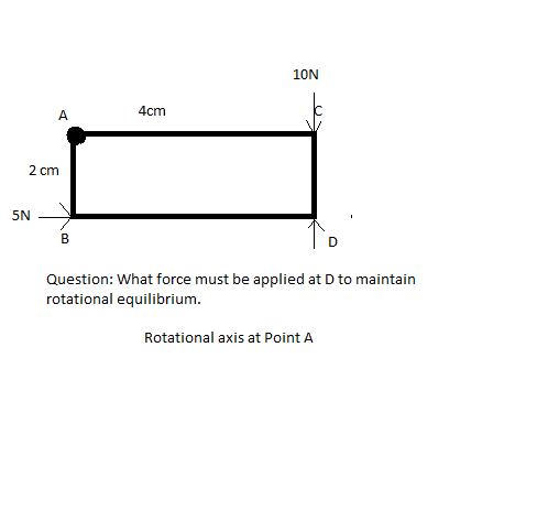

Hello I've attached the problem. Any help would be greatly appreciated.
I understand that by giving us the clue of rotational equilibrium, it means net T has to be 0. The force at 10N will cause clockwise torque (T= rF, so T = .04m * 10N). The thing that confuses me is the force at point B, will it cause counterwise torque or no torque? Also I know the force that we are finding at point D will give us counterclockwise torque, but is the moment arm or lever arm going to be .04m too?
Thank You.

Hi reder! Welcome to PF! :smile:
You're right there!
Think about a situation of such a hinged block, and you applying adequate force to it at the lower end(B). Would it rotate? If yes, which way?
By definition, torque about a point is the force multiplied by the perpendicular distance between the line of action of force and the point. What does that tell you about the lever arm length? :wink:
My guess would be, it would rotate counterclockwise.
By definition, torque about a point is the force multiplied by the perpendicular distance between the line of action of force and the point. What does that tell you about the lever arm length? :wink:[/QUOTE]
So I can just extend the line of action of force at point D and this in turn would make it the lever arm .04m.
So if I am taking clockwise as negative torque and counterclockwise as positive torque... - -.04(10N) + (5N) (.02) + (F) (.04)= 0
.4 = .1+ .04F
F = 7.5N...(Is my reasoning correct)...
Also thanks for a quick reply...
Right-o!
.4 = .1+ .04F
Absolutely.
Thx infinitum for the help...
