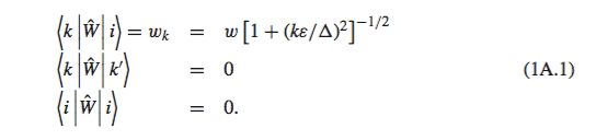

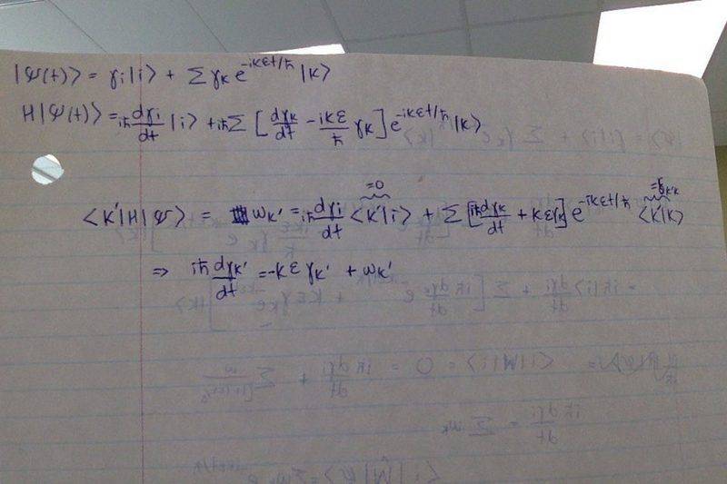

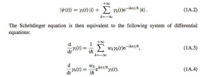

Given 1A.1 and 1A.2, I have been trying to apply the Schrödinger equation to reproduce 1A.3 and 1A.4 but have been struggling a bit. I was under the assumption that by applying ##\hat{W} \rvert {\psi} \rangle= i\hbar \frac {d}{dt} \rvert{\psi} \rangle## and then taking ##\langle{k'} \lvert \hat{W} \rvert{\psi} \rangle ## and ## \langle{i}\lvert \hat{W} \rvert{\psi} \rangle## would allow me to produce 1A.3 and 1A.4. I may very well be incorrect in my methods, but did the following rough calculation and got a very different result. (In my calculation, I assumed ## \hat{W} = H ##.)
Any clarification on how to reproduce 1A.3 and 1A.4 would be greatly appreciated.

## \hat {W} ## is defined as the interaction Hamiltonian. ##|i\rangle## is the initial state the system is prepared in and ##|k\rangle## are all possible states it can evolve into where k is allowed to take all values between ## - \infty ## to ## \infty ## except ##i##.

The initial state ## \rvert i \rangle ## has an energy equal to 0, and each state is separated in energy by a difference of ##\varepsilon##. The energy difference between ## \rvert i \rangle ## and ## \rvert k \rangle ## is k##\varepsilon##.
Sure. This is Introduction to Quantum Optics by Grynberg and this problem begins on page 34.
So ##\hat{H} | k \rangle = k \varepsilon | k \rangle + \hat{W} | k \rangle##. Try that in your method.
I got it, thank you!
