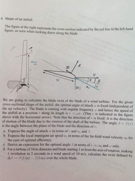

See attachment
Im not sure how to solve c and d...

What answer do you get?
I don't even know where to start!
