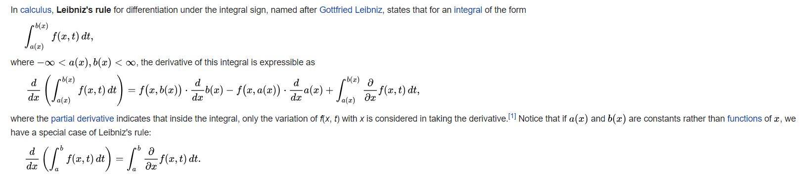

So, do we apply the following statement?
I like Serena said:
I think it would mean that we merely have to be able to differentiate $e^{-\frac{(x-s)^2}{4kt}}$ with respect to both $x$ and $t$ infinitely many times.
Doesn't this only suffice when we differentiate in respect to $x$ ?
Because differentiating in respect to $t$, we also have to take into consideration the term $\frac{1}{2 \sqrt{k \pi t}}$. Or am I wrong ?
Yep.

Leibniz's integral theorem states that the boundaries have to be finite. That is, $a(x),b(x)<+\infty$.
So we still need to address that.
I believe we can 'swap' limits if the limits converge though.
That is, I believe the following holds - if the limits that are involved actually exist:
$$\pd {}x \int_{-\infty}^{+\infty} f(x,s)\,ds \\
= \lim_{h\to 0} \frac{\lim_{a\to\infty}\int_{-a}^{+a} f(x+h,s)\,ds - \lim_{a\to\infty}\int_{-a}^{+a} f(x,s)\,ds}{h} \\
= \lim_{a\to\infty} \lim_{h\to 0} \frac{\int_{-a}^{+a} f(x+h,s)\,ds - \int_{-a}^{+a} f(x,s)\,ds}{h} \\
= \lim_{a\to\infty} \pd{}x \int_{-a}^{+a} f(x,s)\,ds \\
= \lim_{a\to\infty} \int_{-a}^{+a} \pd{}x f(x,s)\,ds
