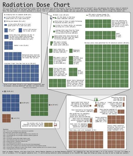

I don't know anything about the dogs, but I do have a Sievert lethal radiation doses chart. See attachment.
