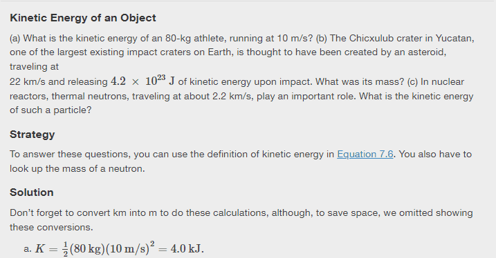

For this part(a),
Why do they give 2 sig figs in the solution? ##80 kg## and ## 10 m/s## both have 1 sig fig.
Thank you for your help!
The answer is 4000 N-m.
It depends on the convention being used in the textbook you are learning from. Because neither input is expressed in scientific notation, we cannot know whether the trailing "0" in "80" or in "10" are significant or not.
One can adopt the pessimistic attitude and judge them to have 1 significant figure as you have done.
Or one can adopt an optimistic attitude and judge them to have 2 significant figures as the text seems to have done.
There is no right or wrong here. If we do not know how reliable the inputs are, we cannot know how reliable the outputs will be. There is no certainty to be had about these inputs. Best advice is to use the conventions established in your text book and ask the teacher for clarification.
There are more reliable ways of doing an error analysis here. One (pessimistic) way would be to look at error bars. Figure the energy based on ##\frac{1}{2}(75 \text{ kg})(9.5 \text{ m/s})^2 =## you tell us and based on ##\frac{1}{2}(85 \text{ kg})(10.5 \text{ m/s})^2 = ## you tell us.
The resulting error bar will be pretty bad. Less than one significant figure.

Thank you for you reply @jbriggs444! That is very helpful. The absolute uncertainty in the kinetic energy would be
##K = 4000 ± 1000 J##
Many thanks!

Maybe, but evaluating that is beyond the scope of the problem:
If you say a human has a mass of 80 kg then it's probably between 75 and 85.
If you say a human runs 10 m/s (great sprint speed), it won't be 5 m/s (long-distance running speed) and it won't be 15 m/s either (exceeding the world record). It's likely between 9 and 11 m/s.
Using the extremes in both cases leads to a kinetic energy between 3040 J and 5140 J.
Note how critical this range depends on the assumptions. If we say the velocity has to be between 9.5 and 10.5 m/s then the range narrows to 3380 J to 4690 J.
4 kJ, 4.0 kJ and 4000 J are all reasonable answers for this problem.
