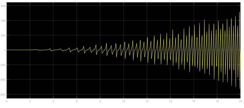

I mean the angular acceleration of the crank
the moment of inertia of the mechanism referred to the motor shaft is not a costant but it should be periodic in a closed mechanism
the same for the angular acceleration if the torque is constant (see attached file)
  • Line plot on a black background of a yellow signal against time from 0 to 20, with vertical values from -600 to 600. The signal stays near zero until about 3, then oscillates with sharp spikes whose amplitude grows steadily, reaching roughly plus and minus 500 near 20.
But if the links has to be linear accelerated back and forth and no energy is lost and you put more in with that torque the plot is precisely what to be expected. Note that average acceleration seem to be constant consistent with your constant torque.
It would be very helpful if you posted a sketch of the linkage. Also label the units of both axes of the output plot.
Your results could be the result of a simulation error. A constant torque into a four bar linkage should show a linear acceleration with sinusoidal variation superimposed. The linear acceleration is from a constant torque into a system with mass, zero friction, and zero energy removed from the system. The sinusoidal variation is due to the accelerations of the various links, and should be periodic at each revolution of the input shaft.
Your plot does not show that. The total acceleration is increasing exponentially, not linearly. You should be able to estimate the linear acceleration from the inertia of the input shaft and the applied torque, and compare to the output plot. Your plot also does not show any sinusoidal variation in angular acceleration. Instead, it has spikes with amplitude that vary from revolution to revolution. The likely cause of both of these is that the time steps are far too small.
Whenever doing any sort of dynamic simulation, always check your time steps. For a four bar linkage, 100 time steps per revolution might be excessive, and 10 steps per revolution will almost certainly be insufficient. This plot looks like the time steps were specified as the number of calculation steps per revolution of the input shaft. In that case, change "time steps" to "calculation interval" or the appropriate term for your software.
Thanks Filip and jrmichler
I suppose that the total acceleration should be periodic at each revolution since the moment of inertia at the shaft should depend only on the current geometry of the linkage
So I dont expect variable spikes whose amplitude not only vary but even increase from revolution to revolution
as I said I used the four bars Simscape multibody sample supplied with the software with standard settings (time steps etc )
the only modification I did was to apply a constant torque and to use the "transform sensing" block to sense the angular acceleration of the shaft

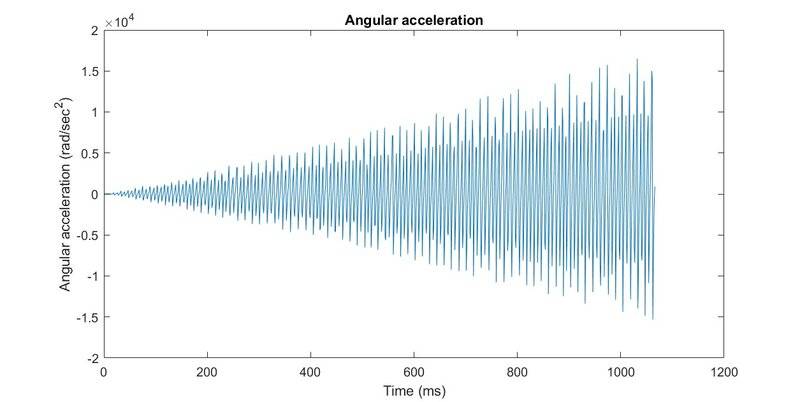

I attach the scaled plot c/w with units
the trend is the same as the previous one...of course
Line plot titled Angular acceleration: angular acceleration (rad/sec², scale ×10⁴) against time (ms) from 0 to about 1070 ms, an oscillation whose amplitude grows steadily, reaching about ±1.5×10⁴ near 1000 ms.
You still never shared the linkage with us that @jrmichler asked of you. If we had it, we could do some actual physics/mathematics to examine it.
If ##t=0##, and the torque ##T## is constant, ##\alpha## should be some non-zero initial value - your plot shows ##0 [1/s^2]##@ ##t= 0## ? Also, this whole plot occurs over 1 second...

Looks like numerical instability as jrmichler mentioned.
I assume the model does not include elastic dynamics (either distributed on the links or as explicit linear/torsional springs), but if it does include such elements then the fast oscillations could also be a result of (possibly unstable integrated) mechanical elasticity.

Your plot starts at zero, and its over a 1 second.
I would advise against being nasty, you've only just shared the units with us right now! How the hechk do we know you didn't bungle that?
