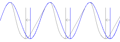

Yeah, that's what I was thinking you meant, but I'm looking for a slighly different compress/expand.
I'm needing smoothness from one timeframe transition (modification) to the next.
This time I too created a pic for you (by hand).
I hope you can see from my pic how smoothly the curve adjusts.
Thanks again.
