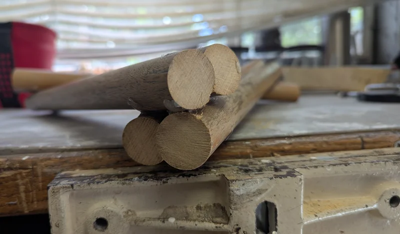

But it could be glued together so that all six touch each other; it just wouldn't sit flush with the four bottom pencils lying flat on the surface. It would rock a tiny bit.
Now I'm pretty confused. My intuition says it will work as a non-planar structure. But, every time you move a pencil to close the gap at a vertex, you change another vertex, creating another error to fix. Does this process converge? It seems like it ought to.

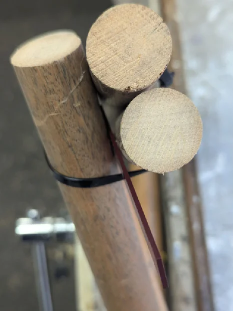

Somehow I knew I would end up with this. Now I'm 99.9% sure it works.
Plus (bonus!) I used up some of the very many old broom sticks I am compelled to save. Also, I avoided painting my bathroom for at least an hour.
I’m not convinced they all touch.

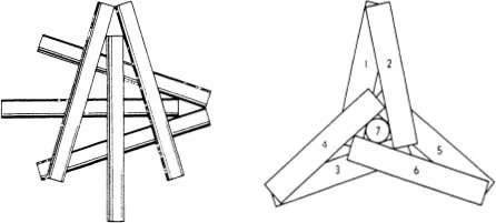

I can tell you that the solution in the Martin Gardner book matches the solution in post #3 above but hints there are others.

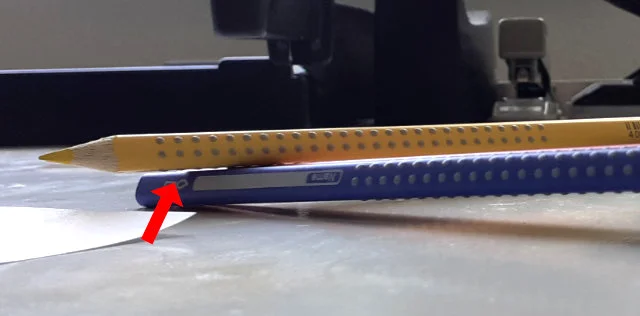

I tested "solution" #6 with real pens and can confirm that they don't all touch each other.
There's a small, visible gap. And I can slide a piece of paper into it.

Here is Martin Gardner’s solution for 7 which also is a solution for 6 along side his original solution for 6.
Remove #7 and it is a different solution for 6 pencils.

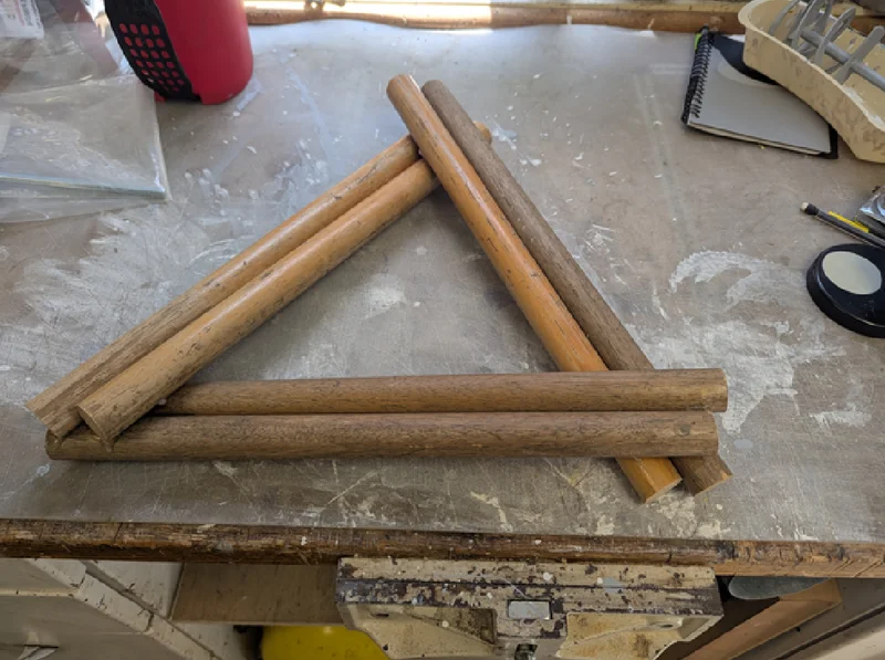

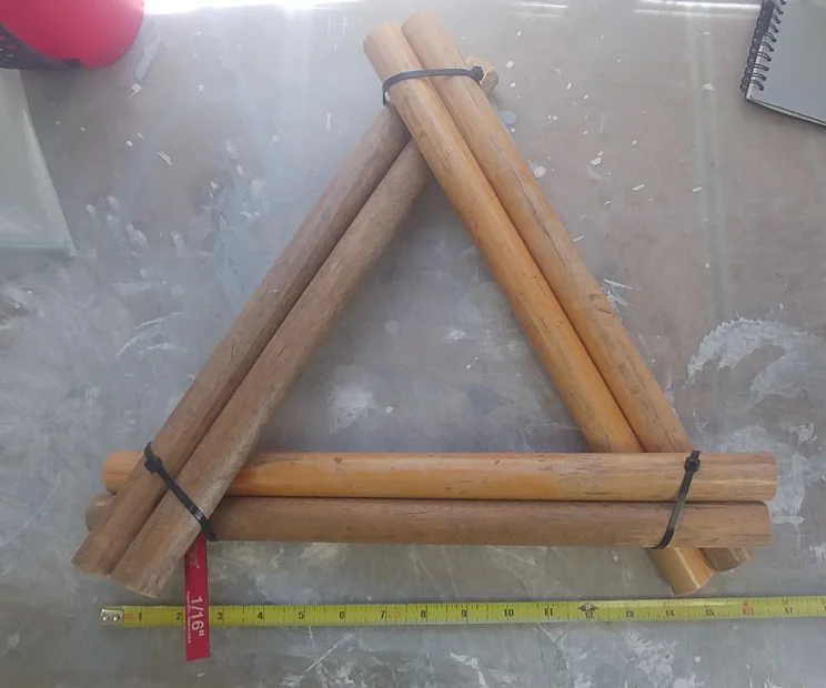

And... Version 2. Now I'm 99.9% sure it doesn't work. Although it's hard to show in a photo. The cable ties are a nice easy solution which allows you to slide and rotate the sticks. There's always 1 gap you can't get rid of where an inner stick misses an outer stick (you get to choose which one, of course).
Also, no surprise, the asymmetric configuration with one leg below the other four crossing sticks doesn't work. But it's a lot closer, which surprised me.
I think there is no loss of generality by using square pegs which lay flat in the plane. Then the gap would be quite easy to see.
Which plane? No two sticks are coplanar, everything's twisted a bit. Anyway, the gap is easy to see in person, particularly because you can slide and twist things around without improvement. It's just hard to demonstrate here.
