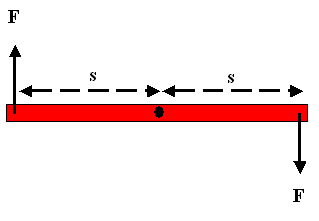

It doesn't always have to be. Like I said before, you can have the moment of a force, but you can also have a special moment, which is called a couple, which is produced by equal and opposite forces F which are separated from one another by a distance d = 2s.
https://en.wikipedia.org/wiki/Couple_(mechanics)
The moment produced has a magnitude of M = F * 2s = F * d. There is no net force since the Fs are equal in magnitude but acting in opposite directions.
Statically, the couple created by the two forces acting on the beam above can be located anywhere along the length of the beam without changing the net of the forces and moments acting on the beam.
If there were only one force acting on the beam above, you could move the force F from the end of the beam to the center and add a couple of magnitude F * s. As far as the statics of the beam is concerned, both situations are equivalent.
