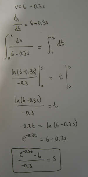

A car's velocity can be described by v=6-0.3s. Find its acceleration at t=100s
v=ds/dt, a=dv/dt
This was actually a two part question, where the first part required you to find s at t=100.
So I wrote:
ds/dt = 6-0.3s and integrated that equation to get:
s=(e-0.3t-6)/(-0.3)
From which I found that at t=100s, s=20m
For the second part,
a=dv/dt=(dv/ds)*v
To find dv/ds term, I took the derivative of v=6-0.3s and got v'=-0.3. I put the known formulas into the equation above to get:
a=-0.3(6-0.3s)
I know that at t=100s s=20, so I can find the acceleration at t=100 (equivalent to s=20):
a=-0.3(6-0.3*20)=0
I think my thought process makes sense (it usually does), but I might be doing something stupid and not realizing it. Long story short, I just don't like a=0. However, I know some people got 0 as well and some actually got a number (this was on a midterm).
Is it right? And if not, can you please point out the area where I'm doing something wrong?

As for the integration, here is the process:
Maybe my mistake is there? Although this is like the fourth time I've done it today and I still get the same thing. It could be something fundamental I guess.
Soo.. I don't know. Any more ideas?
The integral itself is correct, what is wrong is in the application of the limits on the LHS. What do you get on the LHS when s = 0 (lower limit)?
As for the rounding, keep the expression until the last step, and then plug in the values. As I said, it is okay for part 1 but not for part 2. We can get to that once you fix the integral.
Oh! I get it!
ln(6)/-0.3 = -5.973, and thus I should have added 5.973 to the LHS. Gaaah. I'm just so used to leaving out the variable=0 term. AAAH.
Anyways, okay, now it makes sense I guess. Thanks!
Good.
Now for the rounding part: It is better to not use the value for s you obtain in the first part, directly in your equation for the second part. Instead substitute the expression for s, and plug in the value of t. This should give you a better result.
What is even better is to assume in the original problem that v = A - Bs where A and B are constants. Work out both parts of the problem using A and B; and finally substitute the values of A and B. This will give you different results, even with a solar-powered calculator. In general, when you subtract two large numbers that are almost the same, calculators tend to give you shaky results.
