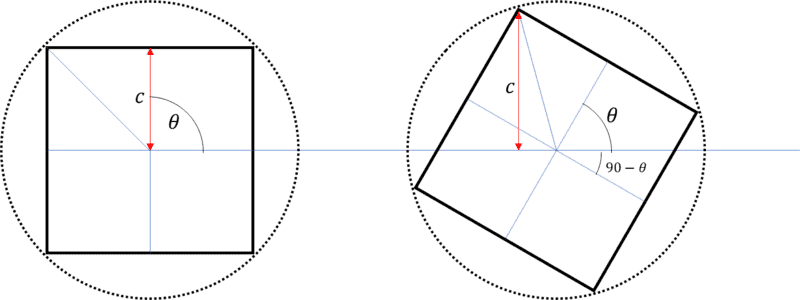

I'm getting a quartic in ##c##, is there a way around that...perhaps something elegant I'm missing?

At 45 degrees, c is h/sqrt(2)
At 0 and 90 it's 0.
Seems cos(theta-45degrees)h/sqrt(2) to me

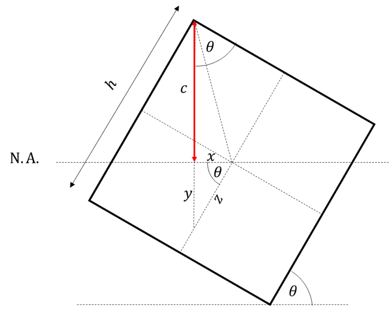

I have the following system from the variables shown the diagram:
$$ ( c + y )^2 = \left( \frac{h}{2}+ z\right)^2 + \frac{h^2}{4}$$
$$ c^2 + x^2 = \frac{h^2}{2}$$
$$ z^2 = x^2 + y^2 $$
$$ \frac{y}{x}= \tan \theta $$
I solved the system for ##\theta = 60°## ( it was a good bit of algebra, and I was thinking about a particular ##\theta## originally):
$$ 16c^4 - 8 \sqrt{3} h c^3 - 6 h^2c^2 + 4 \sqrt{3}h^3 c - h^4 = 0 $$

##h## and ##\theta## are the parameters. All those other variables ##y,x,z## are just intermediate variables to define the triangles which make up the system of equations.
The goal is to solve for ##c##, given ##h##, and ##\theta##. Unless I've messed up that results in a quartic polynomial in the variable ##c##.
Okay. So if you take the center of that square as your X,Y origin as well as the center of rotation, then the top of C is a point that simply follows a circle and the length of c is the y coordinate of that point.
Like this:
The one on the left ##\theta = 90° , c = \frac{h}{2}## , and the one on the right ##\theta = 60°, c= ?##
##c## is always the maximum vertical distance from the horizontal axis to a point on the square for a particular angle.
If I solved the system, the one on the right is given by:

Except in your left square, I would have drawn line segment 'c' from the top left corner point of the square down to the x-axis. That way, as the square continues to rotate counter-clockwise, it's still easy to tract 'C'. Also in the left frame, you left out the theta. It should go all the way to that diagonal line segment.
I'm confused. The angle I have labeled is ##\theta## in both diagrams. It's referenced from horizontal, it represents the angle the right side of the square makes w.r.t. horizontal.

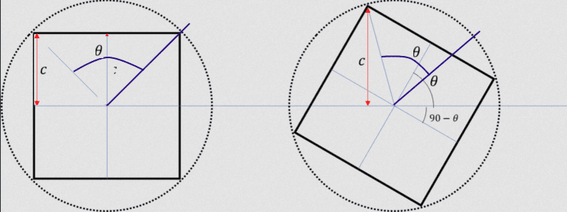

A bit messy - but I measuring theta from that x=y segment
Theta is 90 degrees on the left panel. It's about 60 on the right.
The point is that theta+pi/4 is the angle from x,y=1,0 to the top of C.

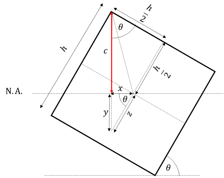

Can you (anyone) find which equation in the system in post #3 is not true? Surely, I've bungled one of them ( atleast)? And they seem so straight forward its driving me bonkers... I've updated the diagram to be more clear, and just reposted the system.
$$ ( c + y )^2 = \left( \frac{h}{2}+ z\right)^2 + \frac{h^2}{4} \tag{1}$$
$$ c^2 + x^2 = \frac{h^2}{2}\tag{2}$$
$$ z^2 = x^2 + y^2 \tag{3} $$
$$ \frac{y}{x}= \tan \theta \tag{4} $$
I see how it works out, thanks for taking the time to explain that. I agree with what you are saying.

I think these are correct. I just don't think they help you. Eliminating [itex]x = z\cos\theta[/itex] and [itex]y = z \sin \theta[/itex] leads you to a system in [itex]c[/itex] and [itex]z[/itex], but it's not an easy system to solve.
The triangle you care about is the one with sides [itex]c[/itex], [itex]x[/itex] and [itex]h/\sqrt{2}[/itex]. This is a right-angled triangle, and you can work out the angle [itex]\alpha[/itex] of this triangle at the centre of the square: clearly [itex]\alpha + \theta + \frac \pi 4 = \pi[/itex]. Hence [tex] c = \frac{h}{\sqrt{2}} \sin \left(\pi - \theta - \frac \pi 4\right).[/tex] This simplifies to the expression [itex]\frac12h(\sin \theta + \cos \theta)[/itex] I gave earlier.

What I don't understand is when is solve the system I'm getting a quartic in ##c##. If that were the case, it means that the solution of some quartic is ##\cos \beta##. Is that possible?
It looks right to me. I observed that the line N.A. is ##c## above the bottom corner from symmetry, and hence by inspection of the vertical extent of two sides of the square ##2c=h(\sin\theta+\cos\theta)##. You can plug this, with ##\theta=60°##, into your quartic and show that it's a solution. Factoring out that solution gives you a cubic, the solutions to which are ##c=\pm h/\sqrt 2## and ##c=(\sqrt{3}-1)h/4##.
Writing the quartic with a general ##\theta## and noting that it looks like two of the solutions are ##c=(\sin\theta\pm\cos\theta)/2## might be helpful in figuring out what's going on with it.

Expand (1) and clear fractions:
$$ 2c^2 + 4c y + 2y^2 = h^2+ 2hz + 2z^2$$
Substitute (3) for ##z## and ##z^2##
$$ 2c^2 + 4c y + 2y^2 = h^2+ 2h\sqrt{x^2+y^2} + 2 \left( x^2 + y^2\right)$$
Then sub (4) to eliminate ##y##:
$$ 2c^2 + 4c x \tan \theta + 2x^2 \tan^2 \theta = h^2+ 2h\sqrt{x^2+x^2 \tan^2 \theta} + 2 \left( x^2 + x^2 \tan^2 \theta\right)$$
$$ \implies 2c^2 + 2\left( 2c \tan \theta -h \sec \theta \right)x -2x^2 -h^2 = 0$$
Then sub(2) to eliminate ##\implies x^2 = \frac{h^2}{2} - c^2##:
$$ 2c^2 + 2\left( 2c \tan \theta -h \sec \theta \right)\sqrt{\frac{h^2}{2} - c^2} -2\left( \frac{h^2}{2} - c^2 \right) -h^2 = 0 $$
Then Expand, collect like terms and isolate the root and square both sides:
$$ \left[ 2 \left( 2c \tan \theta -h \sec \theta\right) \sqrt{\frac{h^2}{2} - c^2} \right]^2 = \left( 2h^2 -4c^2 \right)^2 $$
If you expand all that I get a quartic. The solution proposed indicates indicated that a zero of the quartic is ## \frac{h}{\sqrt{2}} \cos \left( \theta - \frac{\pi}{4} \right)##.

But it factorises as two quadratics.
Leave [itex]2h^2 -4c^2[/itex] as [itex]4\left(\frac{h^2}2 - c^2\right)[/itex]. A factor of 2 can then be cancelled, and, after squaring, both sides will have a factor [itex]\left(\frac{h^2}2 - c^2\right)[/itex]. Assuming this factor is non-zero, we can cancel it to get a quadratic [tex] 4\left( \frac{h^2}2 - c^2 \right) = (2c\tan\theta - h\sec\theta)^2.[/tex] Expanding this and simplifying some trig functions we get [tex] 4c^2\sec^2\theta - 4ch\sec\theta \tan\theta + h^2 \sec^2 \theta - 2h^2 = 0[/tex] and multiplying by [itex]\cos^2\theta[/itex] we get [tex] \begin{split}<br /> 0 &= 4c^2 - 4ch\sin \theta + h^2 - 2h^2 \cos^2 \theta \\<br /> &= 4c^2 - 4ch\sin \theta + h^2 \sin^2 \theta - h^2 \cos^2 \theta \\<br /> &= (2c - h\sin\theta)^2 - h^2 \cos^2 \theta.<br /> \end{split}[/tex] Thus we have the four roots [tex] \frac{h}{\sqrt 2}, \quad -\frac{h}{\sqrt 2},\quad \frac{h(\sin \theta + \cos \theta)}{2},\quad \frac{h(\sin \theta - \cos \theta)}{2}.[/tex]
