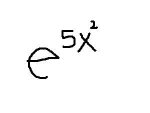

just another quick question:
what is the antiderivative of e^5x^2 ?
looks like this:
I'm not exactly sure if it is entirely "using integration tables" but if you make the substitution u= x9 so that du= 9 x8dx you get a form where you can use the second of your integrals.
[tex]e^{5x^2}[/tex] does not have an "elementary" anti-derivative. It can be written in terms of the "error function"
Erf(x).
