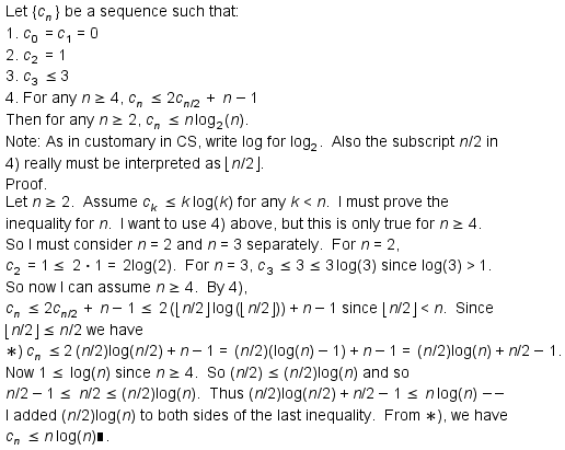

Hi,
The attachment answers your question. The induction is just a little tricky. Presumably, this is the number of comparisons in some algorithm for a list of length n.
