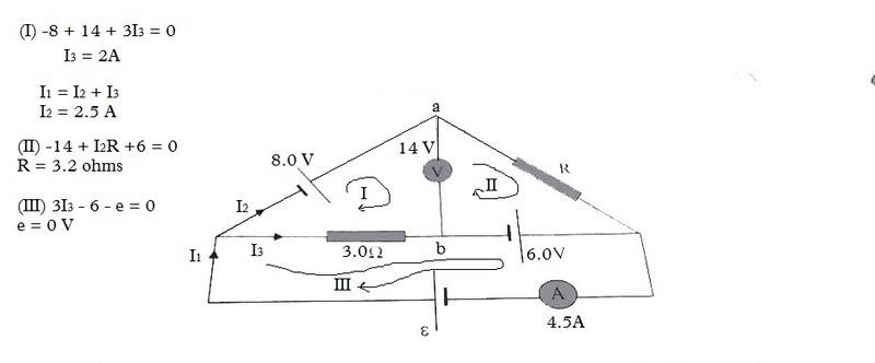

Solve KVL for R and e: 3.2 Ohms, 0 Volts

promusician
The question wants to find R and e (epsilon), I found R to be 3.2 ohms but epsilon is 0 volts, which is very weird. original question is attached.[/B]
http://[ATTACH=full]200051[/ATTACH]
[h2]Homework Equations[/h2][h2]The Attempt at a Solution[/h2]
I also assumed infinite resistance for voltmeter and zero resistance for ammeter[/B]

  • Circuit schematic with three loops labelled I, II and III, branch currents I1, I2, I3, resistors 3.0 ohm and R, sources 8.0 V, 6.0 V and epsilon, a 14 V voltmeter, a 4.5 A ammeter, and handwritten KVL equations beside it.
