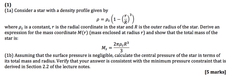

hi, this is my first post here as i have driven insane by a math problem for my final year astronomy class, I've been at it for 3 hours and i can't make sense of it
Typed problem set: a star with density profile rho = rho_c(1 - (r/R)^3), asking for mass coordinate M(r), total mass Ms = 2pi rho_c R^3 / 3, and central pressure in part 1b, marked 5 marks.
is the question even correct as i have made the assumption that the volume of a sphere times the density would give me 4 were there is a 2 and the density p instead of the density constant pc?
The density of the star is not constant throughout its volume. The expression for the density in section (1a) should be written
ρ(r) = ρ[itex]_{c}[/itex](1 - (r/R)[itex]^{3}[/itex])
for clarity. In order to derive M(r) and the total mass, you must do some integrations.
