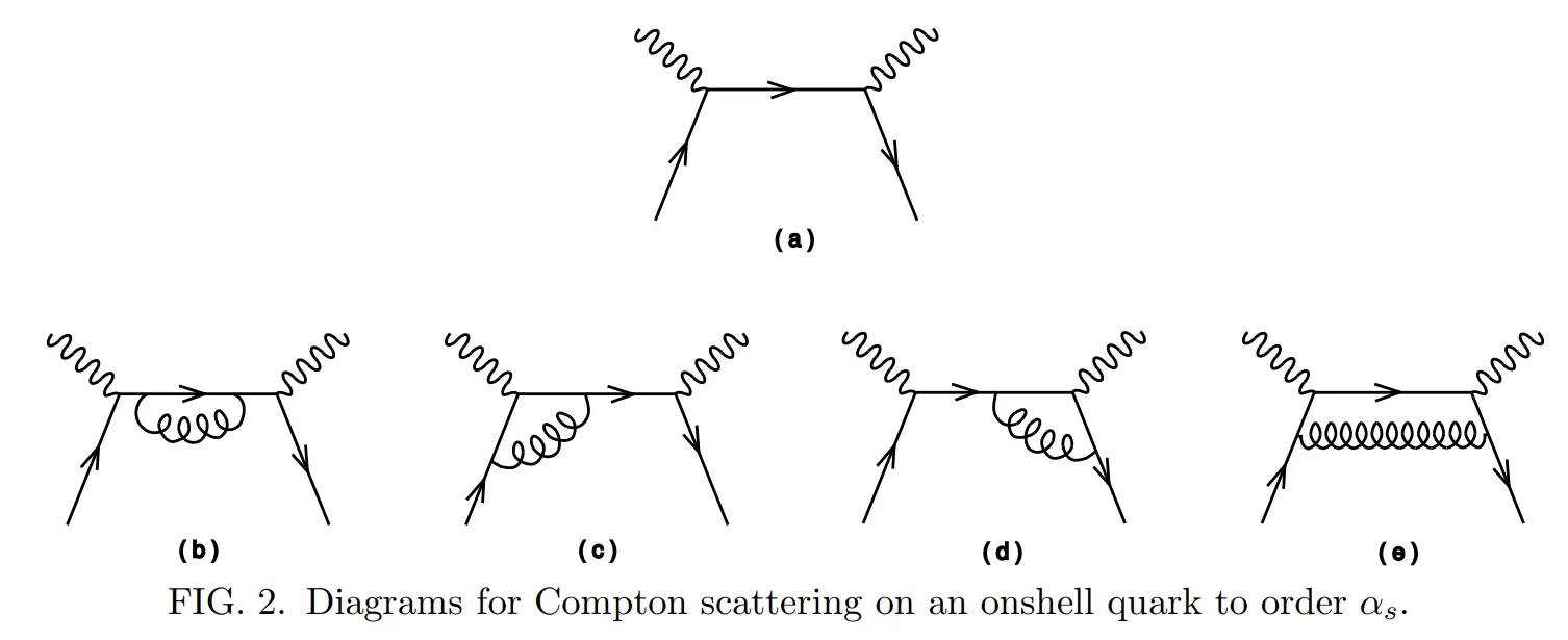

This is problem 2.3 in Griffiths' Introducion to Elementary Particles. I have Griffiths' solutions, otherwise I would be completely lost. Nonetheless, I tried to come up with a solution of my own first. I found only one possibility, which looked ok to me, but it is not even among the 17 ones that Griffiths shows. Here is mine:
What is wrong with it?
It has been a while for me, but I also don't see what's wrong with it. Every vertex should contain two electron lines and one photon line. But I also haven't seen all of the 17 diagrams, so maybe one of them is topologically the same as the one you drew?
renormalize said:
Your drawing is diagram (e).
Yes, that is mine. I just cannot find anything resembling that one among Griffiths' diagrams. Or could it perhaps be this one:
