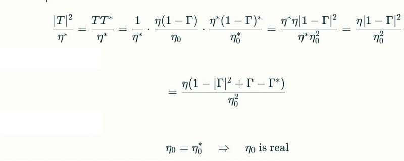

Hi,
Below are the expressions for the electric (E) and magnetic (H) fields in a good conductor.
Two equations for complex plane wave fields: E-tilde t = x-hat T E0 e^(-gamma z), and H-tilde t = y-hat (T E0 / eta*) e^(-gamma z*), with asterisks on eta and z.
Using those, the Poynting vector can be determined as follows.
Equation for the time-averaged Poynting vector: S+ bar = E_t bar cross H_t* bar = z-hat |E0|^2 |T|^2 (1/eta*) e^(-2 alpha z), with the complex conjugate of eta marked by an asterisk.
By applying the appropriate conversions and starting from these equations, we obtain:

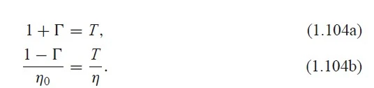

Two equations numbered 1.104a and 1.104b: 1 + Γ = T, and (1 − Γ)/η₀ = T/η.

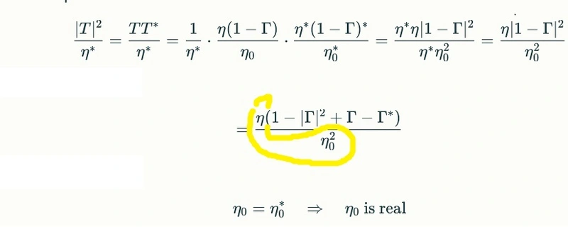

Handwritten-style derivation of |T|^2 / η* = TT*/η* = (1/η*)·η(1−Γ)/η0·η*(1−Γ)*/η0* = η*η|1−Γ|^2/(η*η0^2) = η|1−Γ|^2/η0^2, then = η(1−|Γ|^2+Γ−Γ*)/η0^2, with η0 = η0* so η0 is real, circled in yellow.

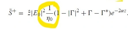

However, the result differs from the one in the book, where the relationship between the two intrinsic impedances is defined differently.
Equation for the time-averaged Poynting vector S+ = z-hat |E0|^2 (1/eta0)(1 - |Gamma|^2 + Gamma - Gamma*) e^(-2 alpha z), with the term 1/eta0 circled in yellow.
  • Two equations numbered 1.104a and 1.104b: 1 + Γ = T, and (1 − Γ)/η₀ = T/η.

  • Handwritten-style algebra deriving |T|^2 / eta* = T T* / eta* = (1/eta*)(eta(1-Gamma)/eta0)(eta*(1-Gamma)*/eta0*) and simplifying, followed by eta(1 - |Gamma|^2 + Gamma - Gamma*)/eta0^2 and the condition eta0 = eta0* so eta0 is real.

  • Equation for the time-averaged Poynting vector in a conductor, with a yellow highlight drawing attention to the term 1/eta_0 on the right-hand side.
