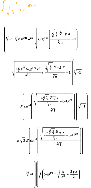

topsquark, I tried the integral at http://integrals.wolfram.com with this input
Code:
1/( (2/3)*g*x + a/(x^2) )^(1/2)
and it gave a BIG monster!

You mean this one right here. It seldom happens that nonlinear ODE-s have solutions which can be expressed in terms of known special functions. But in your case, you got lucky.
Daniel.
