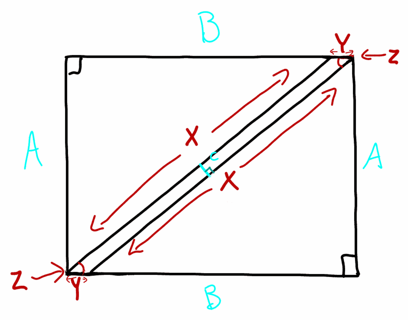

A parallelogram exists within a rectangle which measures 15 inches tall by 20.5 inches wide.
A=15 inches
B=20.5 inches
C=1.5 inches
(C makes a 90° angle with X)
Solve for lengths X and Y and angle Z of the parallelogram and please tell me how you did it!

I think the way I would begin is to observe that the area of the parallelogram is:
$$A_P=1.5X$$
And then we can deconstruct the area of the rectangle into 2 right triangles and the parallelogram:
$$AB=(B-Y)A+1.5X$$
Now, by Pythagoras, we find:
$$B-Y=\sqrt{X^2-A^2}$$
Hence:
$$AB=A\sqrt{X^2-A^2}+1.5X$$
Now you have an equation with only one unknown...can you proceed?
