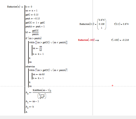

I have a function : (1+x)^1/3 and I need to do reduction in mathcad.
I wrote this :
But the problem is that : it does not work with negative numbers.
How to fix it?

How so? What does your code do or not do?
This code does reduction with positive numbers ( function (x+1)^1/3), but doesn't work with negative. And i don't know how to fix it.
Does the problem occur when your code attempts to raise a negative number to the 1/3 power? If so, algebraically there shouldn't be a problem, but MathCad is probably using logs to compute powers, in which case the expression x + 1 needs to be positive. One workaround would be to have logic that determines the sign of x + 1. If x + 1 turns out to be negative, compute (-x - 1) to the 1/3 power. That should give you a positive number, which you'll need to multiply by -1.

I understand what you're saying, but the problem is that the result should be a real number, not a complex number. The function ##f(x) = \sqrt[3]{x} = x^{1/3}## is defined for all real numbers, and the range is all real numbers, so taking the cube root of -2 (or raising -2 to the 1/3 power) should result in a negative real number. In my previous post I explained why many computer systems produce results that are mathematically incorrect.

##\sqrt[3]{-1} = -1## and ##\sqrt[3]{-8} = -2##, which you can verify by raising -1 and -2 to the third power, respectively.
All of the odd roots (cube root, fifth root, seventh root, etc.) have real values for any real numbers.

Sure, there are n values for the nth root of any real number, but the principal cube root (or fifth root or seventh root, etc.) of any real number is a real number. The principal cube root of 1 is 1, just as the principal square root of 4 (denoted ##\sqrt{4}##) is 2, even though -2 is also a square root of 4. All of the odd roots have one real number principal root, so if you take the cube root of -2, you should get a real number back.

My point is that MathCAD (or whatever) is able to find the square root of a positive number, but should also be able to take an odd root of a negative number, producing a negative real number. Due to the algorithm used, it isn't able to do so, and I gave a workaround for this inability.
I see - your workaround should be fine as long as you only care about the principal root.
