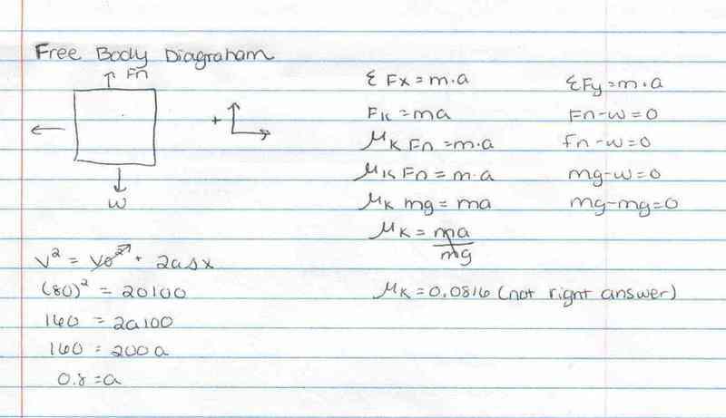

Hey!
I got my masses to cancel out, but I didn't get the right answer. I can't figure out what I did wrong. Here's my work it. :smile:
  • Handwritten physics work on lined paper: a free body diagram of a block with Fn up, w down, and a leftward friction arrow, then force equations, kinetic friction work, and a kinematics calculation ending with a = 0.8 and mu_K = 0.0816 marked not right answer.
Convert 80 miles/hour to m/s!
Also: If he doesn't lock the brakes, the tires won't slip. What kind of friction is that? (Locking the brakes will cause you to skid.)
omg, I can't believe I didn't catch that. Thanks!
