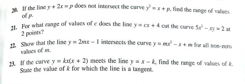

Solve the given inequality Q. 21
chwala
2,854
436
See attachment
Discriminant
Q. 21
Allow me to post using phone... Will amend/ show working when i get hold of computer.In my working I have
##5x^2 -cx^2-4x-2<0##
##56-8c<0##
##c>7##
Textbook says ##7>c## ...who's fooling who here? 😊
I have seen my mistake. I am wrong...put in wrong inequality sign...
Should be ##b^2 - 4ac >0 ##
Cheers guys

[tex](5-c)x^2-4x-2<0[/tex]
We know that 5-c<0 at least so that x^2 term does not go plus infinity as |x| goes infinity.
I saw my mistake. My bad. Hope you good @anuttarasammyak been with you here for some time mate ...
