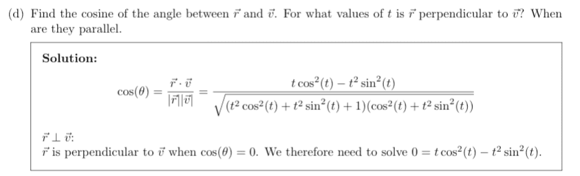

Ok wow I guess I should rephrase my question then, since I thought this was going to be a simplish trig equation. This trig equation is a part of a bigger problem where I am trying to find out what values of t make a position vector and an acceleration vector perpendicular. I've attached a pic of the LaTeX'd problem so far.
I guess my question now is, since it can only be solved numerically, what would this mean for this problem?
  • Typeset worked solution: part (d) asks for cos(θ) between vectors r and v, with cos(θ) = (r·v)/(|r||v|) expressed as t cos²(t) − t² sin²(t) over a square root of a product, and states r is perpendicular to v when t cos²(t) − t² sin²(t) = 0.
Try expressing the equation in terms of ##\tan t## and you can identify where the solutions are from a sketch.

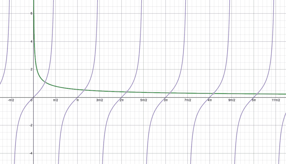

Ok so spent some time trying to graph this thing and wasnt having much luck. Went to Desmos to have a look and it's an absolute nightmare of a graph. Also tried to express ##\tan(t) = \sqrt{\frac{1}{t}}## a different way but of course that gave me the same thing in Desmos. This is assuming ##\cos(t) \neq 0##.
Should I keep going down this route with my equation as is, or find something else?
Edit: May have something, standby.
Yes indeed, I was trying to graph one function instead of two separate ones not sure why. I've got the sketch now though.
Alright I think there are infinite solutions to ##\tan(t) = \sqrt{\frac{1}{t}}## and I see this with the sketch.
Now, these values are not pretty so I'm not sure how to represent what I have here with the original problem.
That is, we had ##0 = t(\cos^2(t)-t\sin^2(t))## and t=0 is one solution. We know there are more solutions by what we just did with the sketch, but how do we use what we just did?

There is one solution for every zero of the ##\tan## function. Plus the solution ##t = 0## itself. The solutions tend to ##n\pi## as ##n## increases, but they are never equal to ##n \pi##.
Note: I've corrected the formual to ##n \pi##.
If we look at the trigonometric equation in a vacuum, I can see how we can say that the solutions tend to ##n\pi##. I also can see that there are an infinite amount of solutions.
But the original question is to find when the vectors are perpendicular (that is, when is cos = 0). So it seems I have an infinite amount of solutions and no way to express them. Because as you say, then TEND to ##n\pi## but they must be exact for the vectors to be perpendicular.
Graph of y = tan(x) in purple and y = 1/x in green over x from -π/2 to about 12π/2, with gray dots marking their intersections at x = 0 and roughly every π after the first.
For reference, these points of intersection are all solutions to the equation (in other words, when my two vectors are perpendicular). But am I correct if I say that there is no explicit way to state every single solution here?
That's right, you just label your solutions ##t_n## or whatever and refer to them that way. ##t_n \rightarrow n \pi## for large ##n## is quite an important point. It means the zeroes quickly become almost periodic.
