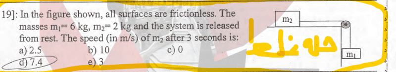

As in the first provided picture:
Newton second law
This is the problem:

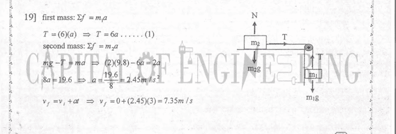

And this the answer provided by the examiner:

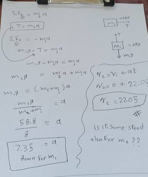

And this is my own answer:
So what did I get wrong???
Also I want to know if the Velocity is the same for both masses.
The diagram shows m_1 as the hanging mass, but the given solution switches that. Your work is fine.
Sure---they are connected. (The speeds are the same, but they move in different directions, of course.)
Oh lord, he switched the masses :doh:
