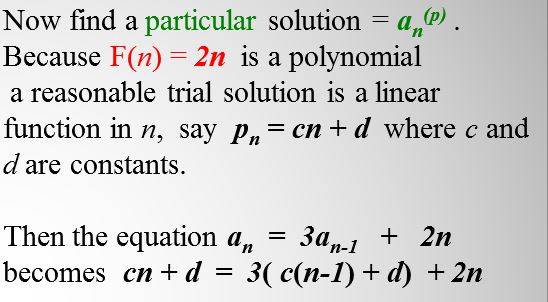

Did not understand how this $$a_n=3a_n-1 + 2n$$ changed into $$cn + d = 3(c(n-1) + d) + 2n$$

You need to wrap your code within the math tags. The simplest way is to click the $\Sigma$ button on the toolbar (above the post field where you compose your post) to generate the tags, and then type your code in between them.
They are letting:
$$a_n=p_n=cn+d$$
And so wherever $a_n$ occurs in the recurrence, you replace it with $cn+d$. Do you see this is what they have done?
Now it is just a matter of using the method of undetermined coefficients to find $c$ and $d$. :D
Ok i got that, then they have simplified that expression to this expression how did they get this
$$(2 + 2c)n + ( 2d – 3c) = 0$$

They distributed, and then collected like terms and then factored. Give it a try, and if you can't get there, I will post my work. :D
I got it sir. Thanks!
