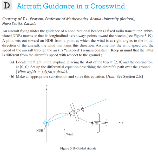

I want to piggyback from this thread:
https://www.physicsforums.com/threads/aircraft-guidance-in-a-crosswind.198836/
this is the question I am attempting to solve, however this thread has been locked
I have found that you can express the two velocities the following way at any point in the planes path:
V(ynet)= (velocity of aircraft)(sin(theta))+V(wind) where theta is the angle between the direction of the aircraft and the x axis, this angle changes as the aircraft reaches its destination
V(xnet)=(velocity of aircraft)(sin(theta))
I suppose now I can use the hint and divide these two equations? how would I go about doing this?

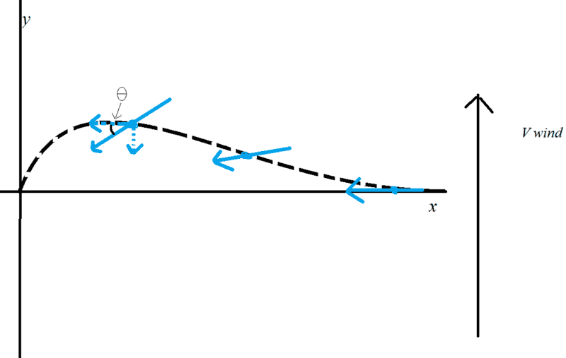

I made a mistake, to find the V in the x-axis I put sin(theta). It should be cos(theta), other than that our equations are pretty much the same, only difference is that we already know that Vwx=0 because the vector of the wind is perpendicular to the initial direction of the aircraft. Take a look at the original problem format and my drawing.

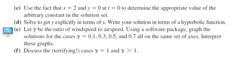

great hints, okay so I let aircraft speed be 10 and wind speed be 1 so as to satisfy the ratio of 0.1 for γ.
this is what I get
