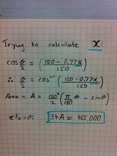

Sorry it is a bit hard to post the entire problem as this is only part of quite a large engineering question.
From the above the unknown is 'x' which is what I want to solve for (again I have skipped out a lot of the working that is irrelevant to you).
If I substitute in THETA to the area 'A' equation then put that into the equation on the bottom I get a huge awful looking equation, only the one unknown but I just don't know how to solve for it. Any guidance please?
You're starting with cos([itex]\theta/2[/itex]) = (150 - .77x)/150.
You solved for [itex]\theta/2[/itex], but didn't solve for x.
To isolate x (i.e., solve for x), multiply both sides of the original equation by 150. Then add -150 to both sides. Finally, divide both sides by -.77 to get x all by itself.
