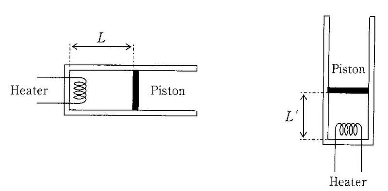

a piston of mass M is attached to a cylinder made from thermal insulation. There is no friction between the piston and the cylinder. At first, the cylinder is placed horizontally and n mol of an ideal gas of monatomic molecule at the same temperature To and the same pressure Po as the atmosphere is contained in the cylinder. The distance from the bottom of the cylinder to the piston is L as shown in the figure. Let the gas constant be R and let the gravitational acceleration be g.
1. when this cylinder was stood perpendicularly, the piston fell slowly and stopped at a height of L' from the bottom. How much was the increase in the internal energy inside the cylinder at this time?
2. how much was the increase in temperature inside the cylinder at this time?
3. after that, when the inside of the cylinder was heated with the heater, the height of the piston returned from L' to L. How much did the temperature in the cylinder increase as compared with the case where the cylinder was placed horizontally?
ideal gas
first law of thermodynamics
1. done (ans : Mg (L - L') )
2. done (ans : 2/3 Mg (L-L') / nR )
3. don't understand to start...

It looks like you have completed a cycle with the final temperature equaling To. Do you have the answer to this problem?

yes, the answer is MgL / nR. How can you know that the final temperature is To? the question asks about How much the temperature in the cylinder increased as compared with the case where the cylinder was placed horizontally, so the answer will be zero (because it is the same) ?
It looks like part 3 is a constant pressure process where Delta U= Q-W. Delta U=1.5R*n*(Tf-Ti), Q=2.5R*n*(Tf-Ti) and W=mg(L-L'). You might try this approach but I don't see how you eliminate L' from the final expression.

The process is isobaric because the pressure of the gas inside the cylinder doesn't change. Pressure before you heat is the atmospheric pressure plus the pressure applied by the piston. This is also the pressure after you heat the gas. If that pressure changes, it'll force the piston to move up and down.
Now use the first law of thermodynamics and the adiabatic index for monatomic gases. It should work out to be some multiple of your answer to part b.
Also consider if your answer should be greater than or less than the answer to part b. Consider the pressure and the volume of the system in both cases. Think about which one would require a greater increase in temperature of the system. That would also help you understand what is going on better.

I don't get it. the pressure could change resulting the piston moving up till it stops when the inner pressure is equal to atmospheric pressure.
ΔU = ΔQ - ΔW, there is heat supply so there must be certain value of ΔQ and I'm not sure if the pressure is constant so I have problem to find ΔW.
the change in volume is the same for part (b) and (c) and I have no idea how to compare both answers. the pressure could be not constant (again :smile:) so the comparison in temperature change between part (b) and (c) can't be determined
Need more hint please. I still don't understand. Thanks

so, if the pressure constant :
ΔW = p ΔV = p A (L - L') = F (L-L') = Mg (L-L')
then how to find the change in temperature? there should be ΔQ because there is heat supplied.
ΔU = ΔQ - ΔW
3/2 nR ΔT = ΔQ - Mg (L-L')...stuck

these processes (b) and (c) occur at the same pressure. because there is heat supplied in (c), I think the change in temperature should be lower than (b)

What is ΔQ for an isobaric process?
ΔQ = n Cp ΔT, where Cp= 5/2 nR ΔT
so, subs that into : 3/2 nR ΔT = ΔQ - Mg (L-L'), I got ΔT = Mg (L-L') / nR
and now to answer the question : How much did the temperature in the cylinder increase as compared with the case where the cylinder was placed horizontally
I tried to find the initial temperature.
T = PV / nR = P AL / nR = FL / nR = MgL / nR
so the change in temperature is MgL' / nR which is differs from the manual (MgL / nR). Where is my mistake?
and I'm not so sure about the bold part (changing F to Mg when finding initial temperature) because it's horizontal, not vertical so the force may not be equal to weight.

Yes, that's right.
T = PV / nR = PAL / nR = FL / nR = MgL / nR
That's not correct. The pressure is equal to the atmospheric pressure. Notice that when the cylinder is placed horizontally, the weight of the piston is a vector that points downwards, not sideways. So it doesn't contribute to the pressure inside the cylinder.

No it isn't. Be careful. Even if your answer in bold was correct, this wouldn't be right. You are subtracting a difference in temperature from an absolute temperature. That gives you another absolute temperature, not a difference. Clear?
