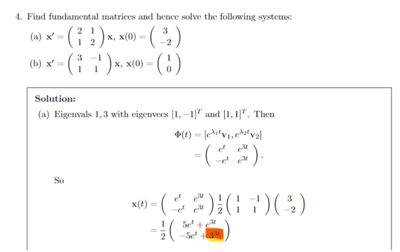

For this problem,
I am confused by the term below. I get all their terms, expect replacing the highlighted term by ##e^{3t}##, does someone please know whether this is yet another typo?
Thanks!
Obviously a typo. And not the first one …
Thank you for your reply @Orodruin! Do you also please know why they include a comma in the matrix fundamental matrix? It seems a strange use of notation to mean.
Thanks!
